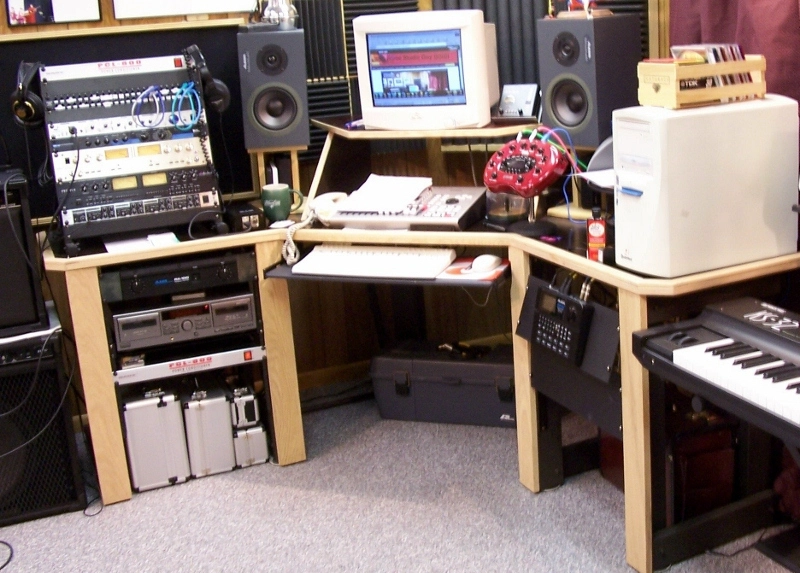

My first desk design was built for corners but it worked well about anywhere.
