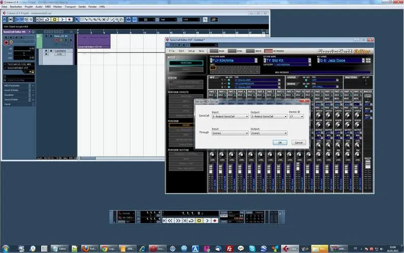

The Sound module can be connected as a USB-Midi, there is a VST plugin... if i connect it that way to the PC, Keyboard to the Midi Interface IN, in Cubase add an Instrument Track and select RolandSonicCell_VST as an instrument, set the Track Input to TASCAM Interface, Track Output to SonicCell. When I launch the VTS plugin of that track, in its menu "Setup Midi Devices" the Midi Input/Output is set to Roland SonicCell(itself).
So, with this setup I start recording, then some data is being recorded, which I can monitor only on Sound Module (via Headphones). So it was my last experiment trying to solve it. Pleace anybody, if any idea of solving this problem: Physical Connection Setup and the Setup in the Cubase, or VST plugin...
