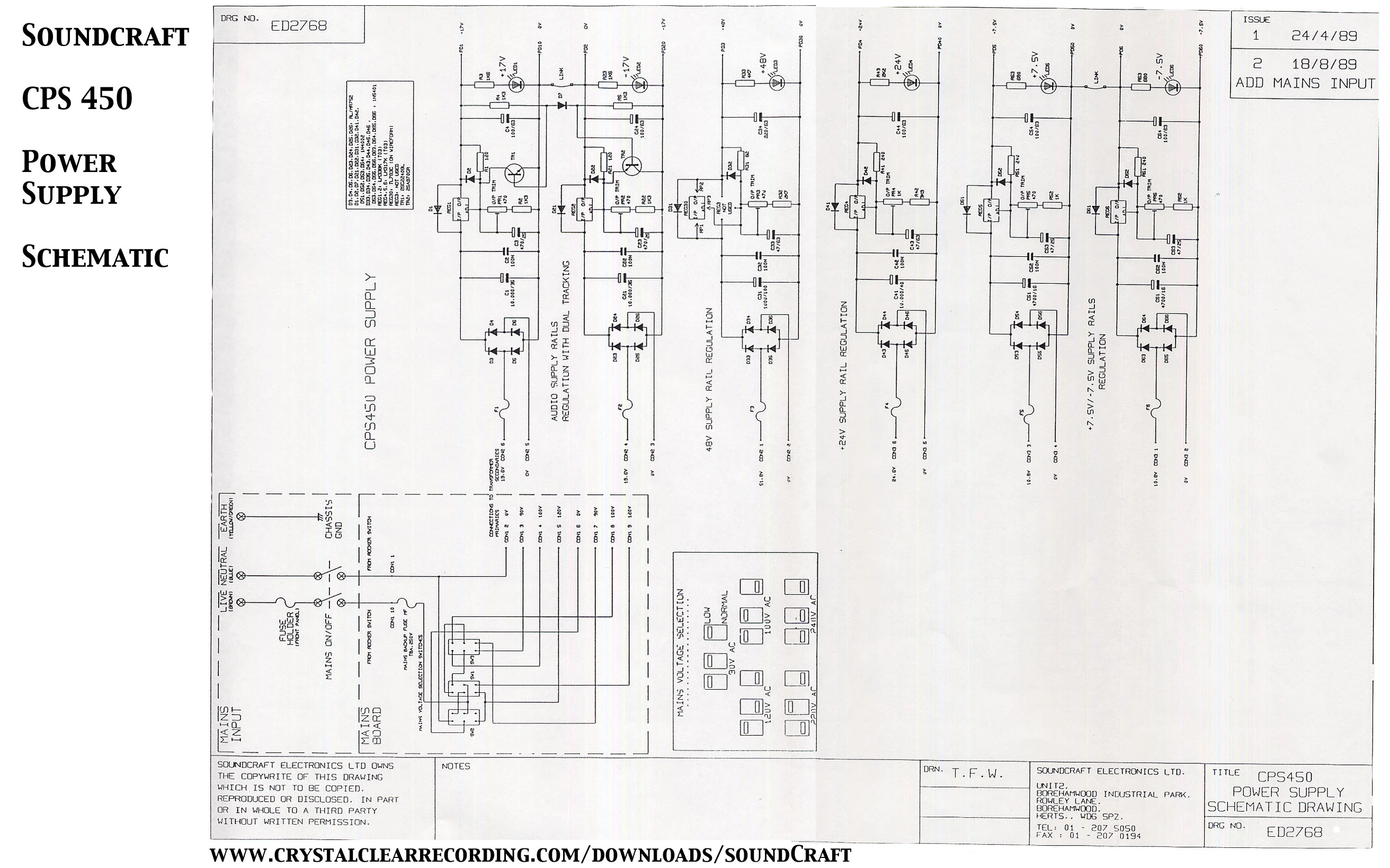

So the regulators were fine. The issue was a 10000uf capacitor that has gone bad, though not visibly. I found the exact schematic online, for the CPS 450 power supply. I'm posting it here for other people's reference. I put a temporary cap in (450uf @ 35V) to test and both LED's came back on.
I have some replacement capacitors on the way. While I'm in here I am going to replace all the caps on the board since they are all old and I have no idea what maintenance was done to the unit. I'll post back to verify that this fixed the issue.

I notice the preset pots on that schematic, are they decent quality sealed types? If so fine, if not I would replace them with sealed ones. In fact, because they cost very little more I would fit multiturn cermets.

The pots on this board are only for adjusting the voltage output, so they should be fine as is.

Yes, I know what the pots do! The point is open types get dusty and can put "noise" on the supply rails. New sealed pots are a trifling extra cost.
