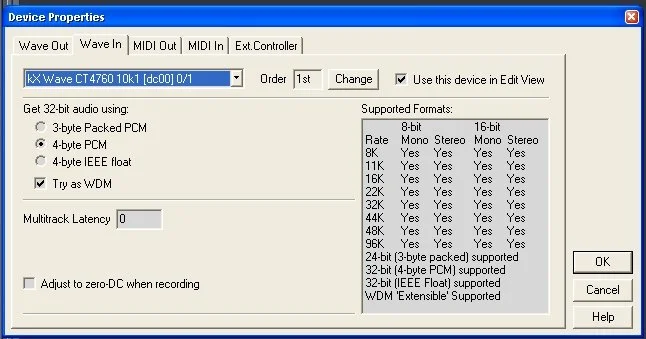

Here is the Device Properties of my SBLive with KX Drivers...
KXWave is the name of SBLive under KXDrivers.
If you all are interested download the drivers or read the KX forum.

Well, the bit rate stuff there is the internal data format that the audio is processed at, no the sampling rate of the hardware. It sure does seem to suggest that 96 kHz files are supported -- but I suspect this means that 96 kHz data can be loaded. To actually play out the Sound Blaster is must be downsampled on the fly... and you certainly cannot get a 96 kHz sampling rate from the hardware on recording.
You need to try... Believe me... Before KXDdrivers there was an hack of the APS drivers (Emu APS - And live shares the same EMU10K1 chip) that was amazing... But with KX you have infinite possibilities. The 96K recording it's not "hardware" (I don't remember how it works... read the KX Forum for technical infos) but you can really hear the difference between 44k and 96k... Then you can use anykind of effect in line in... for example... I'm using an expander, modified by me, as noise gate, and I have a background noise at -114 dB.
I'm surprised that no one here in this forum don't know of KXDrivers. :)
I know the KX drivers. I've used a sblive myself for quite a while.
Like you said yourself, it's definately not hardware. It all goes through the 16 bits/48kHz converters on the card. Everything extra is extrapolated and not how it went into the card.
