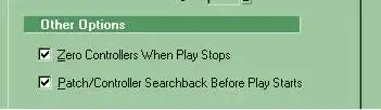

Here's something for you to play around...
First, go Options --> Project --> MIDI Out tab.
You'll find the option at the bottom section.
Uncheck "Zero controller when..."
Uncheck "Patch/controller searchback..."
