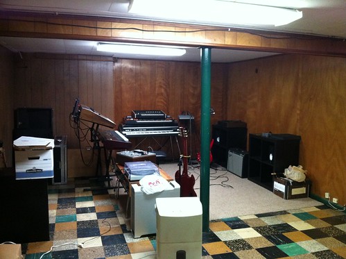

My wife and I bought a house at the end of August (first home, btw), and one of the main perks of the house was the full basement that had potential to be, at the very least, a cool man cave. It's not too nice-looking at the moment, but I wanted to bounce some ideas off of everyone and see if they could help me out with inexpensive ways to make this setup look nice for what it is.
Here's the main "rec room"...
This is the view from the stairwell. (pardon the mess, I'm still reorganizing). The room is just under 300 sq ft so about 20x15. As you can see it's paneled but I kind of want to keep that up and paint it, then treat it with tile. The ceiling I want to keep as is, pull out the fluorescents and install a drop ceiling up to where the post beam sits. That way I can put some insulation inside that and if I keep the original ceiling it will help with noise reduction inside, because the floors are all hardwood and not insulated..

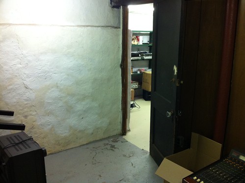

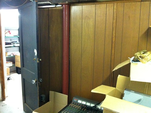

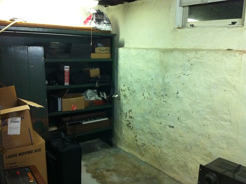

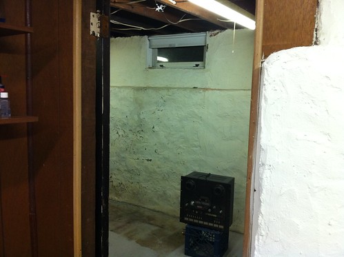

This is a room that runs parallel to the back wall of the main room, so it's directly behind the wall with the Rhodes piano on it. I was hoping to make this into a pseudo-control room once it's treated and finished up a bit, and cut a window out so it will overlook my live room.
I know it looks like utter crap at the moment, but I really want to make something of these rooms.
In the main room I also need to box in the electrical panel and the water meter. I would be laying down carpet over the tiles because those are old asbestos tiles that I do not want to pull up. It's safe if left alone. But they're fugly.
In the control room I may need to tighten up the space a little and install new wall framing around the 3 sides to get away from that concrete. I'd have to put in a drop ceiling and insulation in there too, as well as carpeting. I have been there through a massive east coast hurricane and the historic snow storm and the only water I got in my basement so far was in my laundry room area through the bilko doors and it wasn't much, so I trust having carpeting in those two rooms.

I would keep the cement floors. Carpeting is not really a good idea, unless it's just too cold or whatever. But for sound, you're better off leaving a hard floor like cement or hard-wood. You'll need bass traps in as many corners as possible, including wall/floor corners. Add broad band trapping on the walls. Clouds on the ceiling above your listening are and part of the live room (for drums, etc...) would help too. All this is much more important than weather you carpet the floor or finish the walls.
Also, unless you're really well informed on the subject (I'm not saying you're not, I have no idea), a control room is going to end up being a lot more hassle than you think. A control room has to be sound-proofed from the live room. This is WAY harder to do than you might think (again, I'm not being presumptuous. You might know exactly what you're doing).

Well, assuming this is only going to be my own studio (not tracking others), it gives me a separate place to keep my recording equipment from the instruments, plus gives me more room in the "live room" if I end up getting a spinet piano or something big down the line. So it wouldn't be a real control room pre se, but more a separate little room to hold the gear. But I totally see your point.
You know, on a side note... would it really be a bad idea to keep the brick/stucco walls in the control room? I kinda like the labyrinth look of it, paint it nice and adding a drop ceiling, etc. I'm really trying to save money, but I could always frame out new walls if it really will create an issue. This is also assuming I have proper treatment in all the important places...
I suppose proper treatment could take care of anything :confused:
Proper treatment could call for new walls though :(
But yeah, i guess since even if you had different walls you would have to treat those too, just focusing on treating the walls as they are now would be the same thing. Even if it meant covering the entire walls with panels :o
I'm still learning myself. Just throwing in my 02/100
Shouldn't be to big of an issue. Just having proper bass traps, absorbers, and a cloud above the desk should be fine. Actually test the rooms out if you can, that way you would know exactly what you need and if there are any big problem areas.
How big are the rooms?
I think the control room was something like 16x9, the main room is 20x15. I'm gonna give it a shot with leaving the walls as is and treat them.. You know, just to see. The music I make these days doesn't really go anywhere important!
