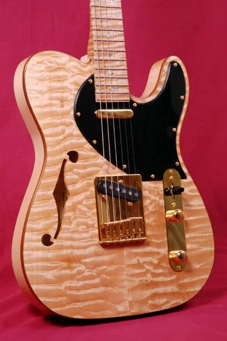

If MSH can pimp his own thread, just for Telepaul here is the latest in tele technology. I did a few and have one the same with chrome fittings I am going to gig with this weekend because I took the chance to build one just for me this time.:D

Wow...just...wow. Looks incredible. Can you give me a break-down of the spec? Interesting finish too, I presume the wood is stained? Have you considered a brass bridge-plate like the Andy Summers Tele? do you wind your own pickups?
And finally, if it's not too much to ask, how much does one of those go for? Feel free to PM if you'd prefer.
And congrats man, congrats!

I'm guessing that body wood cost more than $20 :o
Hey, where's the Bigsby? :confused:

Maple body, capped with quilted maple and bound with walnut.
The neck is flame maple set not bolted with a single action rod set at the body join.
14" radius board and the whole thing finished in clear nitro no staining anywhere all natural.
Hardware is Gotoh bridge and Kluson tuners. The Pickups are hand made by a place not far from me. Not cheap but simply the best. I do wind my own on occasion but only for unusual stuff. All dimensions are pretty much standard fender
I don't build many solid bodies so I haven't played around with bridge alternatives the Gotoh stuff is pretty much my first choice. The spec on this was entirely down to the guy that commissioned it so I couldn't really fiddle too much. I do have another one as I said that I might try stuff out on if I get the time but first I want to get her out and playing. As to cost now I'm jigged up and have the required jigs you'd be looking at about 1.6K adjusted for hardware choice and finish. Solid body a bit off that.

See my comments earlier and also the pic of the tele I posted.
