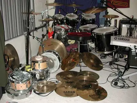

Most drummers don't have a (1) snare drum but several to choose from for different music and applications. I have only 7 and I usually bring three (3)with me to a recording session. I own a Yamaha custom birch absolute fitted with maple rims that is 5.5 or 6" x 14 and this is now my primary snare. I have a custom 9" x 14" 8 ply maple fitted with maple rims that I use when I want a deep sounding drum for heavy blues or rock. I have a 10 ply custom maple that has 45 degree bearing edges is 6" x 14" and is now fitted with cast rims and a groove block and I have it tuned VERY high for certain jazz pieces and for brushes (I usually keep this one on my kit to the left of my hi-hat). I have my old favorite 5'5" x 14" Slingerland mahogany snare that I play when I want a lighter warmer sound or for club dates where I will be playing softer. I have a 4" x 13" maple piccollo that I will use for effects. And I have a 6" x 14" Steel shell snare and a 5'5" x 14" bronze snare that I hardly ever use because they are never right for the type of music I play.
A 45 degree bearing edge gives the head less contact with the shell. (Think of a pointed rooftop)
This causes the head to resonate more, and you typically get a "better" sound out of the drum. It all depends on what sound you're going for.

No, actually it's just the standard birch custom absolute with a stain finish on the shell. It came with the cast rims and I added the maple rims and used the cast rims on another snare. It sounds great. I realy like the Anton Fg model I believe that one is a 7" deep shell though so it's deeper than my Yammy.
I got mine at a real slow day a GC when the salesmen were real hungry and I paid only $225 for it. The Anton Fig would have been another $100 and they wouldn't budge on the price , but I'm happy with what I got. I also have the real deep maple shell snare that I put together with maple rims that gives me a similar sound.
When it comes to drums, I have a REALLY bad case of G.A.S. so I'll probably eventualy get the Anton Fig model too. ;)
