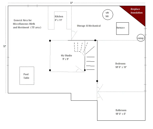

Hi, Michael.
Yeah, that 4' by 4' was bothering me too. I basically did it because there's a window on either side of that 8' wall. My wife, mother-in-law, father-in-law, and I sat down again tonight and banged our heads together to try to come up with a better placement of the rooms. Wouldn't you think the builder should plan his basements to better accomodate all the crap we want to put down there?? :D
Anyway, we think we've found a better spot for the room, which would be approximately 9' x 9' when done and with no windows. Of course, it's going to be square, but I think that at my hobbyist level, I probably don't need to go nuts to have all those wacked-out angles. I'll try to get some traps, baffles, tapestries, etc. to treat the walls and hope for the best. And I think I'm going to go with a basic wall construction, except maybe use sprayed cellulose insulation and double-layered drywall with silicone caulk in between each layer and the stud too. I don't have a drum kit, so the loudest sounds I'll be making will be recording mic'd guitar amps and most of the time I'll probably be using an amp modeler to rough something out anyway.
Basically, I think I've come to the realization that I'm too small-time to do it up right and that I'm not going to have a studio like some of the ones I see posted here or in my dreams - ah, maybe someday though. ;) I'm ok with that.
Here's a rough diagram of the basement and how we have it planned out now, just so you can see. If anyone has any lessons learned that might apply to someone doing a low-budget and really basic kind of studio, of course I would definitely welcome and appreciate them.
This is a great forum, and, even though I'm lightyears away from some of the crazy cool studios I see here, it's neat for me to see them and hear about what everyone's going through to put them together.
Thanks to everyone! :)
-Jeff
