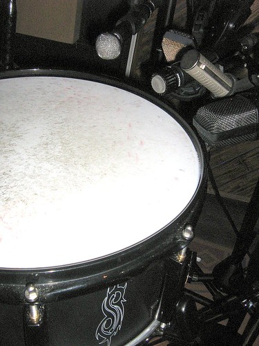

check this out. i know it's a preference thing and whatever works, but i have never seen a 57 placed like this. is this odd or not? it looks like it's pointing straight across the drum almost at rim level. :confused:
I've heard of it done before. Mine is not quite level like that but its pretty close, but that's just due to laziness.
No bottom mic needed

You're.. just playing with us right?
Ok I'll bite. Odd? Not.
When you don't want the big thick low end bonk-hype thing of the close proximity effect to the skin you move toward the rim, even down into the side.
It can still sound thick enough (kit' and whacker dependant) but adds the snap, top end from the snares back in. To me, it's closer to the tone you'd get setting there next to the kit.
Frankly that 'too close to the skin' thing reminds me of one too many bad saloon pa gigs.
As always actual miles may vary. :D
I do it frequently for most of the reasons already mentioned.

no dude. i am a bass player turned home recordist. i've never seen a snare mic'ed like that. i'll give it a whirl. my snare sounds usually suck, probably because i'm using a brass snare and pointing the fucking microphone towards the drum. why didn't someone tell me this earlier? :mad: :p
5 mics on a snare?
So much for being decisive! :D
look at the website, dude. they have 5 diferent mics on the snare, kick, and OH's, and have audio clips of each so you can hear the difference between each microphone.
That's an interesting website.
I was asking myself "why are they doing these tests with the snares off" until they got to the AKG. The sound of that snare kinda gave me a headache.
Maybe they're thinking slap from that mic and getting all the crisp sounds from the overheads, which would probably be fine.
BTW, that's the way I've got my snare mic, mainly because the stand won't go any higher. I have an SM57 but like an old beat up EV PL11 I got for free better. It's not crisp but the overheads give me that.

Generally, isn't what happens is struggle like hell sometimes, move the mic around, things get better.. slowly.:)
I actually like the rim' starting point. But then there's that mild aversion afliction I mentioned so..

I've been astounded with how much your snare sound can change with small microphone placement adjustments. With skinned drums (to me), those fine adjustments are most noticeable in the sound. What one inch one way can change on a snare drum is a lot greater than one inch one way on a guitar cab. That's my opinion but I suggest screwing with it. Proximity and angle to the drum can give a wider varieties of sounds than I expected at first.
I liked the C414 solo snare sound out of those clips on the site the most. The brightness added more of the snares into the picture .. I like getting that bright snare smack in the mic.

generally, but i have to tear down my kit after every song or two that i track and the drums will be down for a few weeks or months while i'm recording everything else. also, i am tracking in the same room as the mixer and i am alone so i don't have the luxury of having the drums in a different room with someone else dialing in the placement for me.
I do almost the exact opposite of that pic. I have my 57 about 2 inches in and literally pointing straight down at the skin, perpedicular to the floor. I ended up doing it that way after many different placement experiments.
I`ve started using a simular aproach, just a bit more angeled towards the head
Two questions; That's going for the rather 'big, thick dry side of things?
2) As in kinda sorta always or something? That I don't get. (You're that settled in? same genre, or I'm reading too much into it..?

:confused: Not really sure what your questions are.
I use the same micing set up 100% of the time. I don't record anyone other than myself on my drum set. So, I found the set up that sounds best for that kit and have stuck to it.

Yeah...I checked out the website. Nice stuff.
I only looked at the picture the first time I saw this thread. :D
Its not really unheard of...seems Ive read how alot of engineers will try to pick up the hi-hat with the same mic...which can be nice if the drummer is using brushes.
Id be curious how the AT4033 worked out...the MD421...the royer and the M88....I have ready access to all of them but the royer...but the M88 is the best kick drum mic I have so I wouldnt use it on snare.
