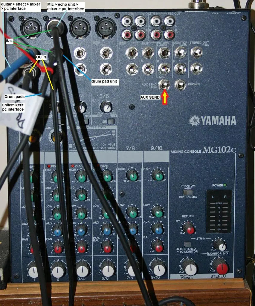

Here's the set-up of the mixer
I have only two channels for dual recording via my interface, so at the moment the guitar takes one channel & the vocals / percussion share the other.
Still have no real idea of how to use the send jack though - where would the 'in' and 'out' jacks from my effects unit go please?
Thanks again :)
Thanks again :)
You shouldn't share inputs like that. Is there a reason you're not connecting the Stereo Out or Rec Out to your interface? Sometimes there's good reason to use the inserts, but I don't know if this is one of them.

Thanks, I'm not sure what you mean though - which jacks should go where please?
Connect Rec Out to your interface's input. Connect your interface's output to 2-Track. Move the drum pads to Channel 3 L/Mono. The Monitor output of the board would go to your studio monitors. Aux Send goes to the input of your effects unit, and the output of the effects could go into 9/10, Return or about any stereo input. Stereo Out could go to the PA amps/speakers.
There are many variations but this should get you started.

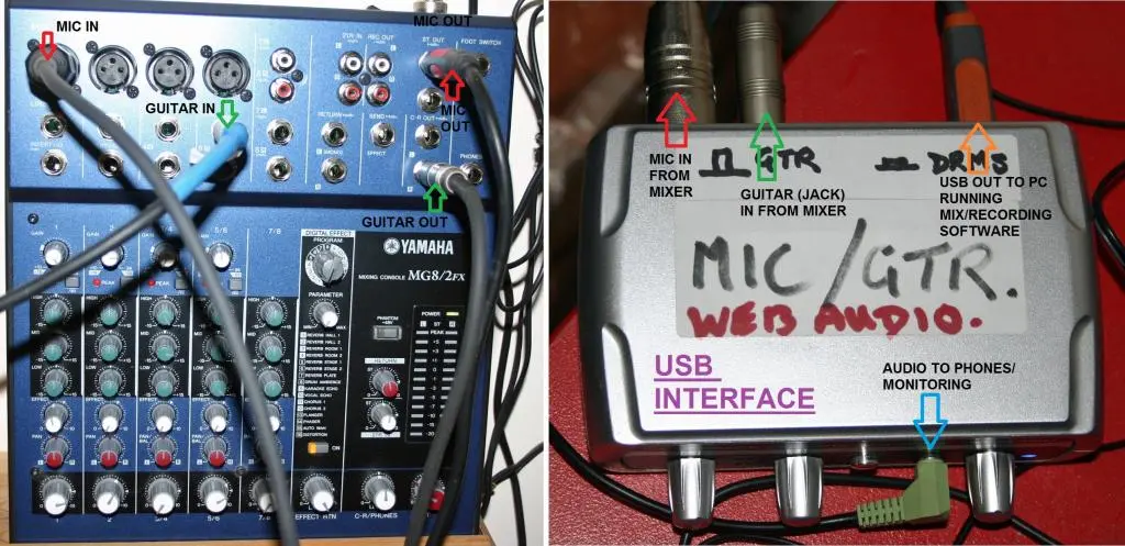

Here's a slightly earlier Yam mixer but with FX. I followed the advice re sockets but am still in a muddle. Can't seem to separate out the mic (vocals) from the guitar - am I plugged in wrong again?
This time it's all electronic via usb interface to a pc mix/record software. It's too complicated simulating a live scenario because of course in a small room the vocal mic is picking up the guitar, so I thought by channelling everything electronically it would be easier to isolate what does what?
Ideally, I'd like an FX on the mic and nothing on the guitar - I'd certainly like to separate the mic from the guitar so I can work on them individually.
Thanks.
C/R Out is for control room monitors but in this case you might not use it. Move the guitar out to the right channel of the stereo out. To record vocal and guitar to separate tracks through that interface pan them to opposite sides on the mixer.
But there's a problem. The built in effects will go to both channels. If you had a separate effects unit you would have the ability to route the effect to one channel with the vocal.
Thanks but aaagh! woops! Whole reason I picked this mixer up was to direct reverb to the mic & leave the guitar clean. I kept wondering why when I turned FX down on the guitar I still got reverb - thought I must be doing something wrong? Apparently not, this may not be the unit for me! :-o
