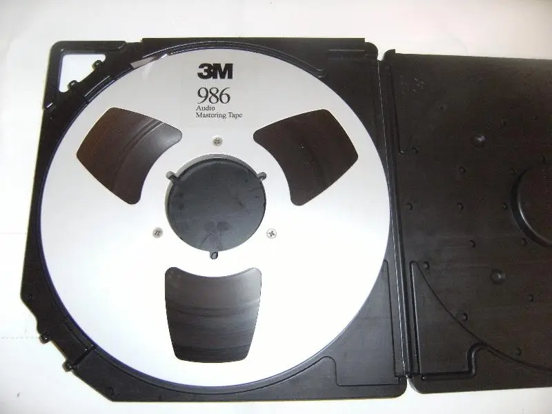

It was indeed 966, which was very quickly renamed 986. Probably because it was too easily confused with the +9 996. 966/986 was the +6 made to replace the ailing 226. Everything went to a 9xx number at that time. 808 was sticky as well, and that was replaced with 908. I actually liked 226 a bit better than Ampex 456 when it first came out, but to each his own. It all comes down to taste. But my all time favorite 3M/scotch tape was and still is 206 and its 1-mil little brother, 207.
If you find 986 its good stuff and is not prone to sticky-shed. And of course there is plenty of NOS 206/207 out there and its all good.
Unfortunately Scotch uses many of the same model numbers now for its adhesive tape, so it is harder to sort out when googling or searching eBay.
