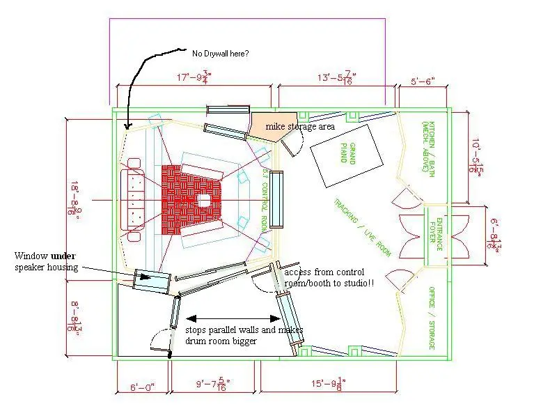

Here's the wall in question:
Its painful, but you have to hang the drywall on the interior side to the airspace before you stand it up. Heavy, sweaty work. I had to do it once in a Studio with 22ft high ceilings.
Build the frame on the floor(obviously) then dry wall the side that you won't be able to access, then stand tha puppy up, wear a hernia belt and a butt plug fro sure. No cussing :mad:
Sorry Mikey, buts its the only way I know how to get it done.

My observation, and it is merely that, is that if you drywall the back side it will in essense create a small drywalled room with inherent volume, modes, and resonances of it's own. We all know what an empty, fully drywalled room sounds like and i wonder what that might impart on your conrol room. My gut reaction would be to leave it open and insulated.

That's kinda where I'm at in my thinking too.
If you take a look at Left Bank you'll see that most of the walls were built backwards. Built on the floor and stood up. The advantage is it gives you an internal cavity to fill with insulation and treat, say with slots etc. It works really well when you are short of space.
As far as the STC is concerned it works fine. Left Bank has no external noise problems yet the air space is only 2", but there's dacron insulation in the cavity.

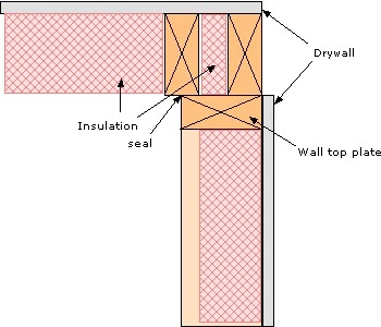

I had a similar question at one time and this is a detail that John provided:
Hope it helps.
Alex
