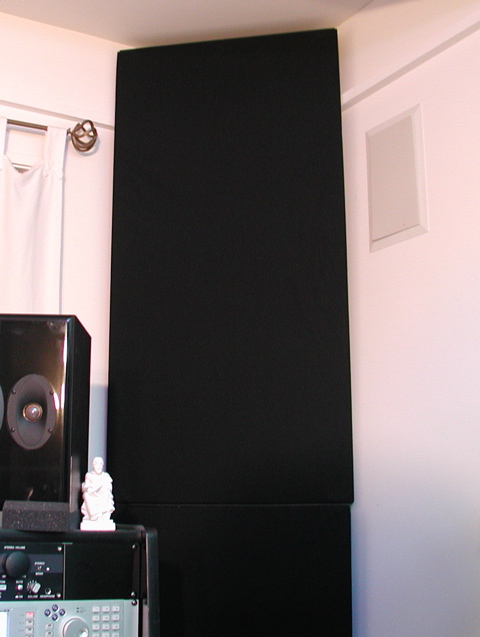

Get some broadband bass traps and place them across the corner. Either buy them, from a company like realtraps, or make your own with a frame and rigid fiberglass, all wrapped in fabric.

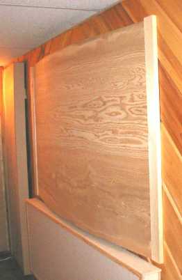

For bass traps, i mean hang them like this:
It's best to keep symmetry, so i'd either have another(bent) reflective surface, on the side opposite the window, like this:
or place absorption panels to block the window, and across from these panels. This won't increase isolation, if that's what you are hoping, just reduce affect a window has on acoustics.

Broadband bass traps, the ones suggested most, absorb mid and high as well. I suggest you keep the mid and high absorption to a minimum, or you will have a dead room at these frequencies, and the bass will still boom.
I'd suggest, minimum treating 4 corners with broadband bass traps, treating the back wall, the side wall and ceiling first reflections, and behind the monitors.
If you add more mid-high absorption(maybe for the slant and/or along the walls/ceilings) then i'd add more bass traps in the corners, although you don't want too much absorption. In certain areas, the back wall/slant, diffusion may be a better idea to keep some liveliness although still helping the problems.
