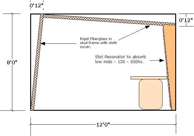

Happy 25th Elvis :) Yes it's a small room for sure. This is how I would approach a small room like this. You don't lose any floor space in this system and will sound as good as you can get a room of this size.
I've heard small rooms done like this, it's not too expensive, and it works. ;)
