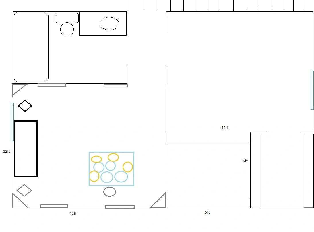

I posted a picture before of my space upstairs but it was incorrect. Below is the proper dimensions and hopefully I can get some input.
I have attached added a couple of basic acoustic panels (they will be constructed of MDF filled with rigid fiberglass). Also some corner traps. I have a ceiling fan so I'm not sure how to work out a cloud yet, but he fan in center of the room.
Is the 5ftx6ft too small to make an isolation type booth? I know small rooms sound small but I also have a lot of back ground noise in my room (neighbors, dogs, lawn mowers, etc). I just want something that I can record cleanly.
Also the strange drawing is a Roland TD10 (drums) I couldn't draw it properly.
