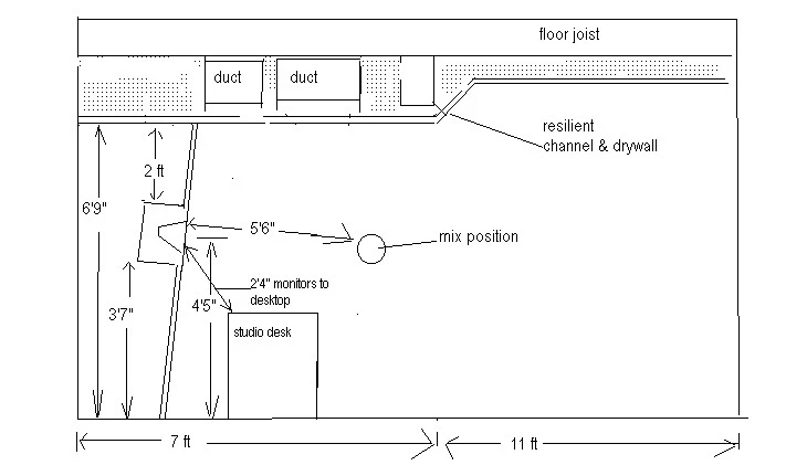

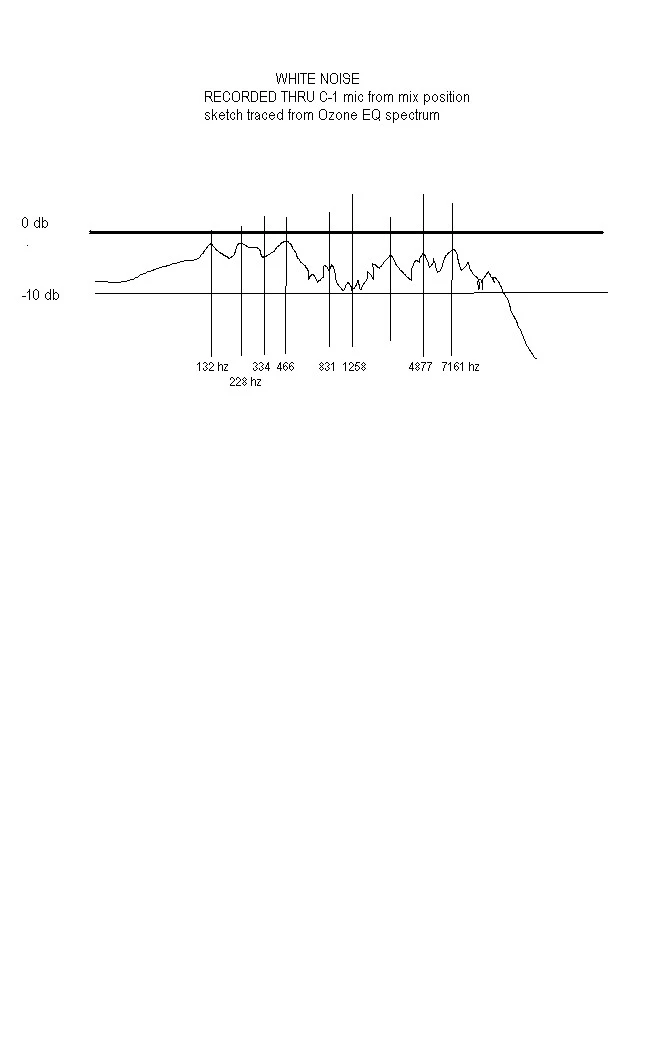

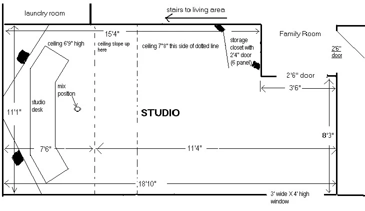

Thanks to all for the advise on building my combination vocal-control room. I am now up and running again! It is now finished except for treatment but I don't want to treat it without some idea of what I am doing. I have attached three sketches I made with microsoft paint.
#1. Floor plan of room- finished with drywall walls and ceiling.
Rubber backed carpet on floor and on the soffet I mounted
my proto-J monitors in. (just for looks, I know it does
nothing for the sound) The only furniture I show is the
studio desk. The rest of the room has typical stuff, file
cab., small chairs, a five drawer chest to store some junk
NO futon, foton, heck NO SMALL COUCH.
#2 Cross section to show what ceiling looks like
#3 sketch of sound spectrum of white noise I recorded thru my
C-1 mic from my mixing position.
Questions!
Why is there a 10 db dip?
How can I determine if the room need treatment, what
treatment, and etc?
Yes, I have searched already and been to John's great site a zillion time. I just need to know what, out of his wall treatments to build.
Thanks,
Larry
attachment #3 White noise
I found out why my white noise attachment would not post, it's to big. Therefore I have zipped it. But it is still a bmp file. My studio does not sound good. Prerecorded songs sound ok but new vocals recorded in my new room sound bad, kind of hollow.
This white noise I recorded thru my C-1 mic from my mix position and played thru proto-j monitors.
any advise would be appreciated!
Thanks,
Larry
attachment #2
Here is the studio cross section
And FINALLY the white noise
Thanks,
larry
Larrye - firstly you must treat that extremely close ceiling over the console. It will create standing waves around the frequencies that are missing (cancelled) in your white noise chart - 400 - 2K
cheers
John

Thanks for your input, I need to go back to John's site and study the theory more. I think I can figure out what to use. But I don't know how much (big) and WHERE to put it. Over the console, on the ceiling. I figure knauf fiberglass, 2" thick,4" thick? Do I need to cover this entire ceiling area?
I will study up on it and maybe John or some other acoustic expert can tell me more specifically.
