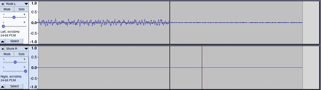

Here is a .WAV of a new test: 20 seconds with the Rode at 50% on the interface and the Shure turned down to 0), then 20 seconds of the Shure at 90% and the Rode turned down to 0. https://www.dropbox.com/s/mvggrt1hmv3ko5m/rode test 3.wav?dl=0
In Audacity, the waveforms look like this:

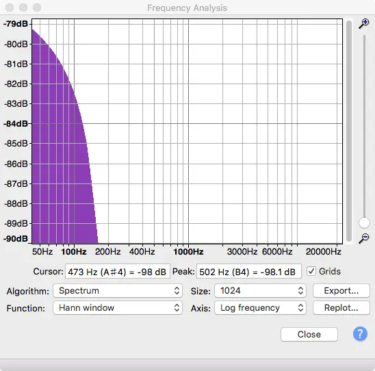

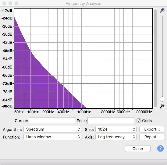

The spectrum plot for the 20-eecond Rode clip is:
The Spectrum plot for the Shure clip is:
What do you make of this?

Taking your wav file, the first part sounds like ambient noise... either an AC or refrigerator motor, or a fan running. Something of that nature. So I took the file, split it when you switch to the SM, and then boosted that portion of the signal to equal the Rode. It's the same noise. Definitely not microphone noise.
Listen to the comparison with the two mics equalized:
I think what is throwing you is that the Rode is almost 15x more sensitive than the Shure. For a pressure of 1 pascal, the Shure puts out 1.6 mV. The Rode puts out 25 mV. That's huge.

On listening, I see what you mean. They do sound the same. There are lots of fans and fridges all over our house. I had turned off the loudest one (the furnace/AC), but the others are not readily turned off.
I was unaware that the sensitivities of the mics were SO different, so thanks for that. Still, a difference of 15x is about 25dB, and Audacity tells me the Rode (RMS) is -23.63dB, while the Shure is -79.11dB, even though the interface record level is set at 50% for the Rode and 90% for the Shure.
A difference of 55dB seems like too much. Also, I wonder -- in the tone generator test (second video above, or see link below), the beeps were barely audible in the Rode, but ran the Shure up to 0dB. So Rode vs. Shure, for the same inputs, the Rode's noise level was higher, but its signal level was lower... can that be right?
