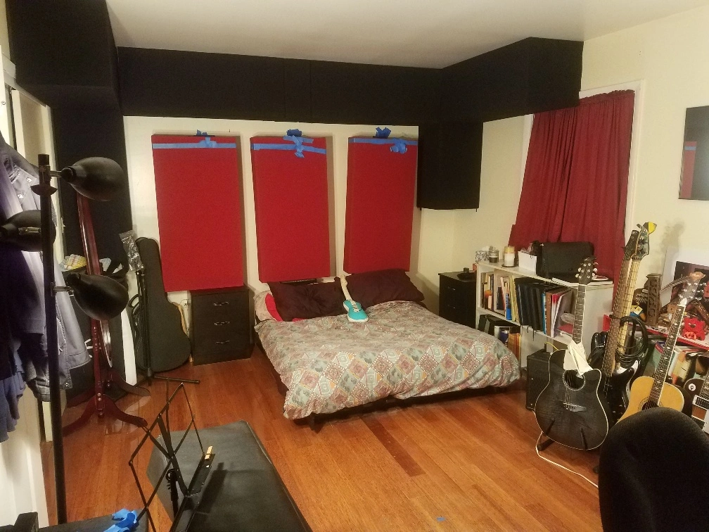

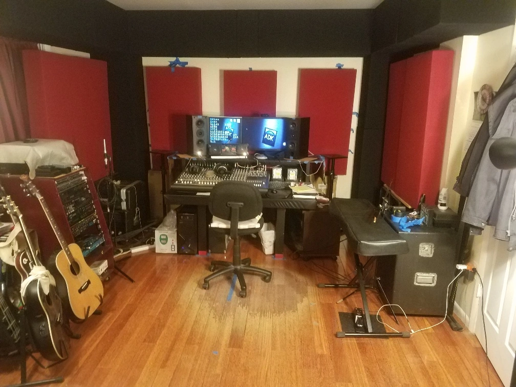

To re-cap, I have a 11.5'W x 18.5'L x 8'H room with 6" thick panels and 17" square soffit style Bass Traps all filled with Roxul Safe'n'Sound.
I have attached pictures of the Front Half and the Back Half of the room.

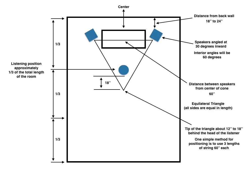

Well...for starters, and this is the rule I follow, your speakers should be about 5'-6' apart...the specific number is something 67.5".
The reason is...at that distance you get the best stereo imaging. So with that set, your mix position would then use that distance to create the triangle.
After that, find the sweet spot in the room...using that 38%...and stick your mix position there and then adjust your speakers and other gear if you need to move everything closer/further from the back wall.
Once you have that...listen to some music. You can then move your chair back a bit for forward to see if you like things more at the point of the triangle or a bit closer to the speaker from inside the point...but that's pretty much your mix position setup.
Doing the REW and moving things 3" forward or back, will not make any difference, because the room is still the same, and that is what the REW is measuring.
Your supposed to set up your monitors and mix position first...and then use REW at that mix position to see how the room reacts and if you need to address anything that is way off (usually the LF in most smaller rooms).
Your trying to use REW to decide where the mix positions should be...and that's not the purpose of REW....and again, at 3" increments, it's not going to change much anyway.
If you set up your mix position as mentioned above...any small tweaks to it are best done using your ears and some reference tracks...and not REW, which will only lead you down a rabbit hole with little value.
This is the setup I use...which is close to the one gecko posted for the angles and general size and layout...but both can work, the choices between their differences will depend on what your ears are telling you.
If you have the room length-wise, which you should with 18'...that 38% has some leeway...so you can try moving the whole setup against the front wall or maybe a couple of feet away. With front ported speakers, you can go against the wall and it may sound better than a foot or so away, because you can get a LF node at the mix position when you're only a few inches to a foot or so away. If you want to be off the front wall, a good 2-3' would be better...so then going against the wall may be easier if you don't have the room to be that far away.
All that, you can decide with your ears. Play some reference tracks...roll that chair a little forward, a little back...see if you can find the sweet spot.
I'll second the suggestion to place the speakers 5'-6' apart and place the listening position at an appropriate distance from that. If you're too close to the speakers it skews imaging.

I disagree with the drawing posted and the point distance behind the head. It should NOT be more than 6" or 15 cm!
It is very important to maintain proper imaging and focus. If your speakers are too far apart, your mixes will suffer from "mono syndrome". ;) (I just made that up) But it's where you mix in stereo and then everyone that listens hears a mono recording... not good.

To answer the original question: Sit yourself at 0.375 times the length of the room. Do NOT move. Use REW to adjust the speaker distance along the 30-degree lines.
Totally agree John.
If speakers are too far apart the sound falls apart, dips in the frequencies, depth, punch and holes in the stereo image and can sound a little " phasey "

If your speakers are too far apart...
What does that mean in actual numbers...?
I find that most people use them too close, and there is no real stereo imaging, it all becomes mono.
The drawing I used above in my previous post, comes directly from Carl Tatz, who knows a thing or two about room design...and who I've spoken to when I first read his points about speaker placement and the need for wider spacing than most people use, otherwise the image suffers. He then confirmed the specific distance needing to be 67.5"...which is also in this article.
http://carltatzdesign.com/downloads/ami-article.pdf
Recording Studio Design in Nashville by Carl Tatz Design - Acoustic Design, Analysis and Implementation
I use to have my speakers wider than most people do...but when I readjusted using the Carl Tatz dimensions...it made a significant improvement, and I've stayed with it since.
Most people in home studios have only a computer monitor in front of them...and they naturally put the speaker monitors on either side, since the 67.5" triangle would put their seated position way back from their computer screen. So they end up choosing speaker placement based on how close they need to sit in front of their computer screen in order to see things, rather than the optimal speaker spread for proper stereo imaging.
A lot of people can do the wider spacing but then they sit too close, often because their mix position is up against a wall due to limited space. That tends to deemphasize things panned center (except below 300Hz), so they tend to mix centered things loud. This happens because of more pronounced head shading and reduced cross bleed.
A similar effect happens when the triangle is the right proportions but too small. The head (and the distance between the ears) becomes proportionately larger relative to speaker distance. The decrease in volume from one speaker to each ear becomes greater due to the distance proportions and you get less cross bleed. This affects all frequencies about the same.
Bottom line, you need the distance between your speakers and distance from them.
Carl is okay, but he's a bit like John Storyk... a hard-line LEDE/RFZ guy. Not that he doesn't know what he's talking about, but he doesn't in a few areas.
I think some of his stuff is GREAT... It's like everyone in this field; We all have our issues. (except for me) LMAO!! ( you KNOW I'm kidding, right? )
But to say that 'so-and-so' does it this way so it must be correct is actually a logical fallacy; Argument from Authority.
Now, we (studio designers and consultants) are experts, not authorities. We NEED to be questioned. It forces us to grow and get better at what we do.
But, yeah, I completely disagree with Carl's drawing. It can only lead to problems if you don't understand what he is trying to explain there.
I'll explain:
The ANGLE of the speakers is irrelevant. The position is what is critical. Carl was including angle and position. (this is confusing)
1. The speakers must be on lines that are 30 degrees left and right of the direction that the listener faces.
2. The focal direction from the mid or tweeter of the speakers MUST intersect with the EAR! The focal point will be no more than 6" or 15 cm behind the head. (important)
3. Measure the distance from the convergence point (6" behind the head) to the mid or tweeter.
4. Position Left and Right speaker so that their separation distance equals #3.
5. Then the speakers SHOULD be angled outward about 5 degrees from their focal direction. This makes the speakers converge at a point much further behind the head! But this does in no way interfere with the imaging or focus like Carl's drawing WILL.
The horizontal coverage of all professional speakers is just as accurate at 5 degrees off-center as it is ON center. But this allows better room coverage and stereo imaging all over the room (as long as the room is properly treated - again NOT LEDE :facepalm:)
I hope this answers your questions. More details in my upcoming book.
