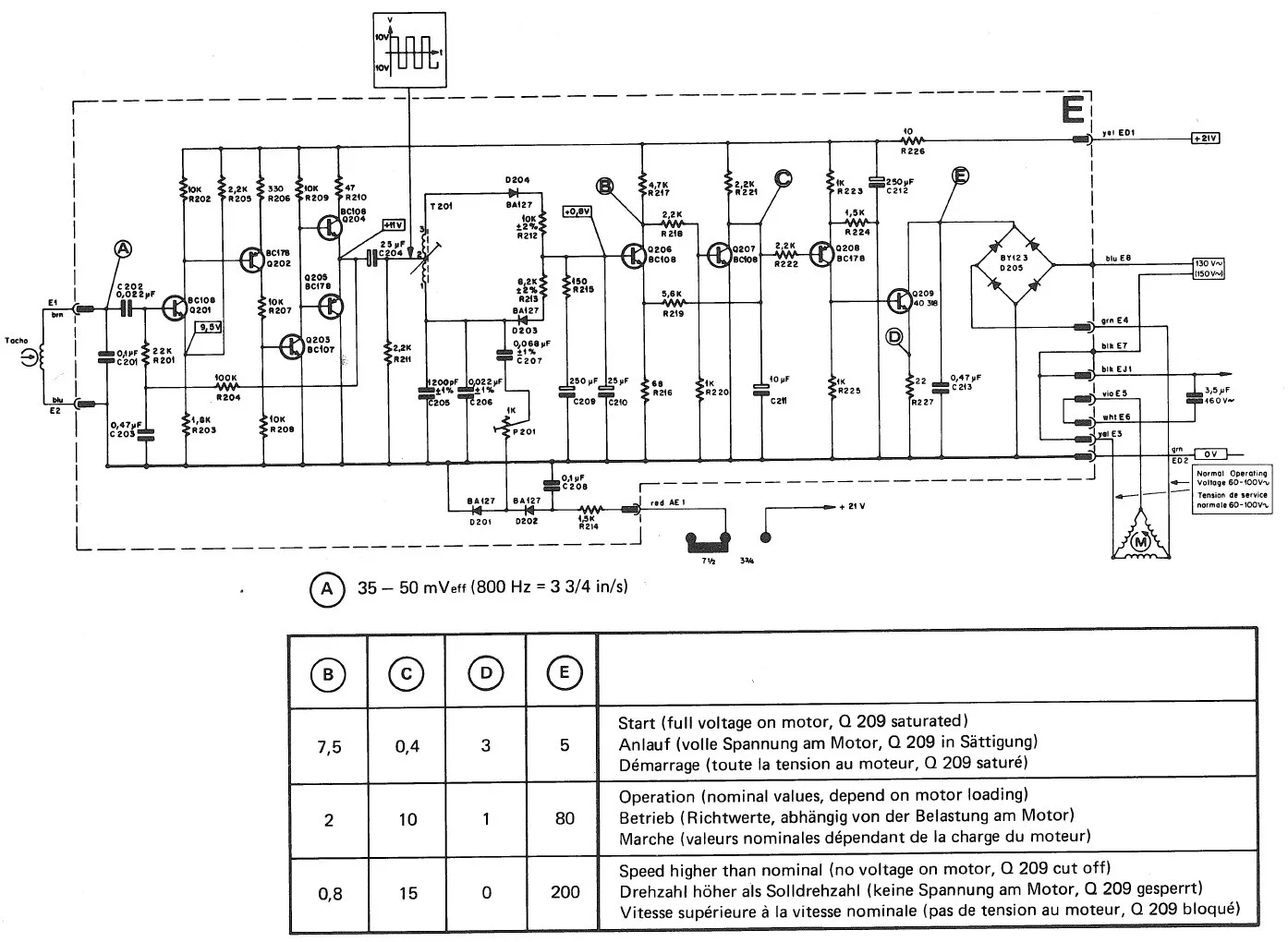

I'm trying to find why this A77 MK2 has its capstan motor spining at maximum speed.
The main psu has been restored and the +21V is ok.
The capstan board has been checked as follows:
- Electrolytics replaced as usual. No polarity errors, no wrong values.
- RCA 40318 transistor found open. I put a 2N3441 in place.
- Diode bridge replaced (motor almost didn't spin before replacing it).
- Motor capacitor replaced (the original was still ok).
- 0.47 "Rifa" replaced by X2 equivalent.
- BC173/183 transistors with oxidized legs were replaced by BC548 / BC558 (later I put two BC108 for Q206/207 for the sake of testing)
- Diodes D203/204 replaced by 1N4148 just for testing (originals tested ok, I plan to put them back in place).
- 1K trimmer replaced.
- Checked each single resistor with one leg removed (all ok)
- Checked the coil (not open, 60-70 ohms)
- Checked all connections numerous times, did a last check of the 2N3441 (ok).
I get the correct +/-10V "square" signal at pin 1 of the coil (as per service manual) so the phonic sensor circuit works ok.
However, it looks like there is nothign around Q206 which cause its collector voltage to drop down to almost 0V, which causes the following transistors to block, hence the unregulated motor speed.
Any ideas ? Thanks !
