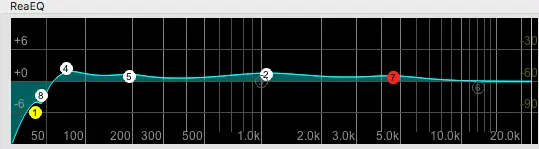

Some of the issues I'm noticing are that the lead vocals are pushed way back, the guitars are mostly just in the side channels (which is leading to some mono compatibility issues). There's also a scratchy sounding thing in the chorus that might be a bit too loud.
Anyway, I did some fiddling to get a ballpark idea of where you could go ...
View attachment fools_mix4_adj1.mp3
EQ Screenshot
Sides: just HP filter at 100hz and little cuts in 200hz and 3k, plus a heafty overall 6db boost.
Then I used a multiband to tame some of the highs, while (hopefully) keeping the balance in check.
