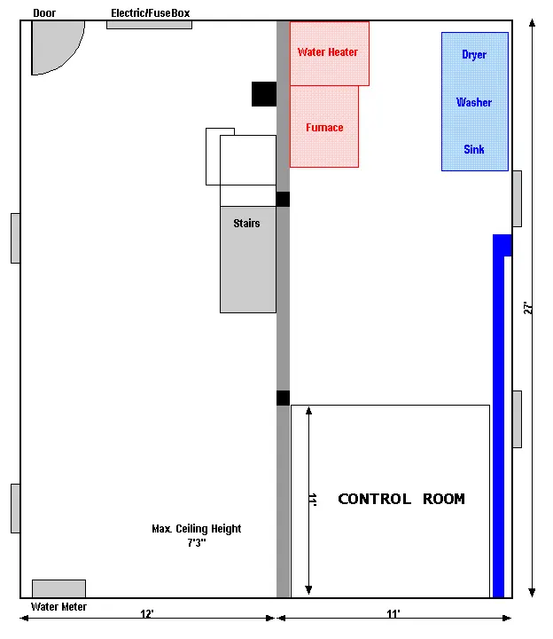

what i have to work with
that sounds like a good idea, the only problem however is that there is a 8"x8" horizontal support beam that runs across the ceiling where the wall separating the CR and studio will be. Therefore, the two sides of the wall will need to be at least 8" apart. I had originally planned to put one set of staggered studs flush with the CR side of the beam, leave 4" dead space, and then frame the other side out from the beam.
OK basically I don't know what the best approach for framing this wall will be, given that there is this 8" beam to deal with. I don't want to give up too much space on either side, but especially on the CR side as room there is more limited. So I will try to post a diagram of my basement that shows the support beam and the location of the two rooms relative to it and hopefully that will give an idea what I'm talking about. The studio area is on the left side of the diagram, the black rectangle at the bottom right is the area where the CR will be, and the thick gray bar down the middle is the horizontal support beam that runs the length of the house. The small black squares are the two vertical support beams, and the large black square is the concrete support leading to the chimney from the furnace.

Adding RC over a staggered stud wall isn't going to have a 5-10 dB improvement in the STC rating. In fact, at STC 48 already, the staggered stud is tough to improve upon. You'd need a staggered stud wall and a RC wall to get just a 3dB improvement in STC (law of logarithms...you need to double or half the power to get a 3dB change).
What you should be more concerned with is the low frequency performance of your walls. STC is a convenient rating, but unfortunately it's set up much like A-weighting, with a heavy emphasis on higher frequencies such as those used in speech (e.g. 1-3 kHz). The low frequency performance of RC walls versus stud walls, and double walls is quite different. I suggest checking out the BBC's website for their journal papers regarding lightweight partitions. Interestingly enough, they found that most double wall constructions don't leave enough airspace between the walls to properly decouple...they acheived excellent low frequency isolation from two single faced walls (multiple layers of sheetrock), with a wide spacing and insulation between.
Cheers, and good luck!
Kris
PS: Your beam framing idea sound fine to me.
