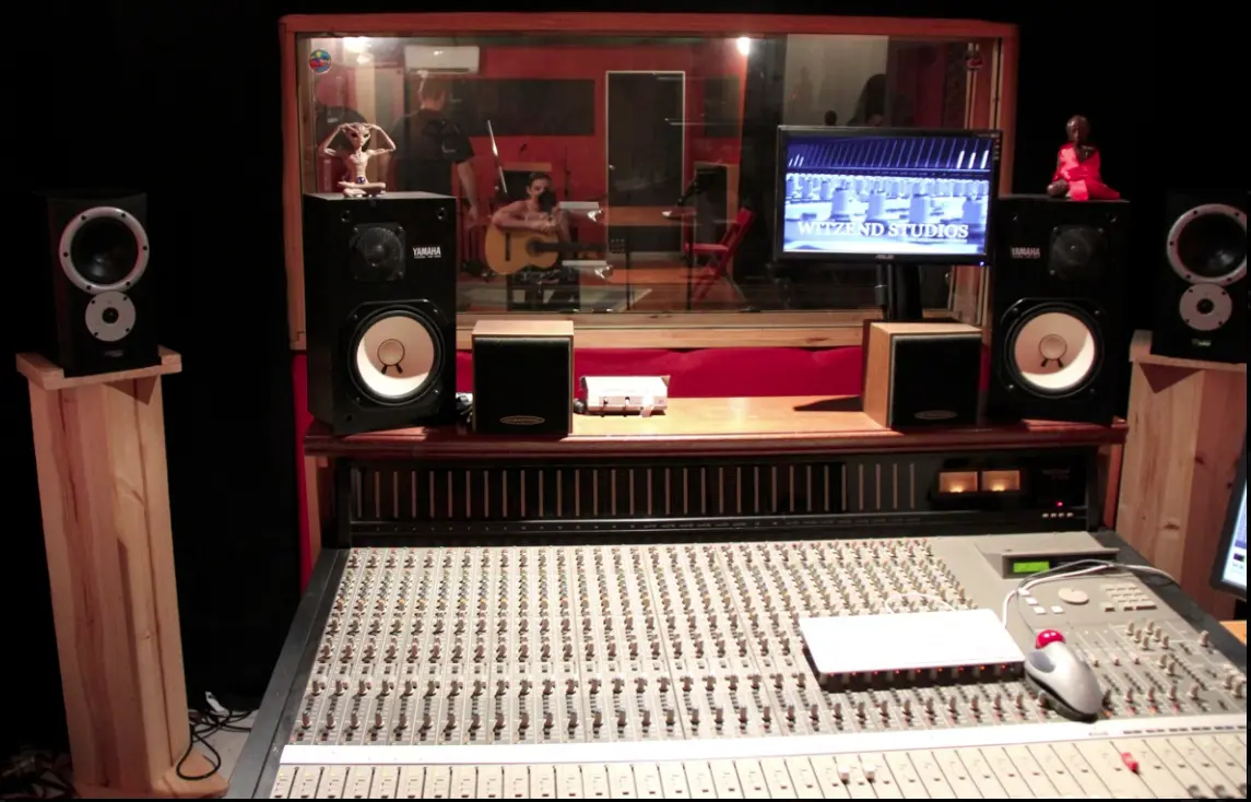

The key feature is strength. A 5Kg speaker attached to a mic stand with a ⅜ or ⅝ threaded attachment puts severe stress on what is a very small surface area. One tug of the cable, or kick of the stand could bring expensive speakers crashing down. If you must use something cheap - how about proper speaker stands, as in the ones for small PA - with the 35mm spigot mounts. Much safer.
Made my own stands for about $20 out of some ply wood. Solid ones too.
Well, maybe more like $50 in todays prices LOL.
Alan.
