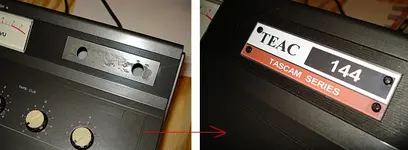

If you are getting annoyed by missing logo on the head-cover of your machine, here's the way to "patch" the problem, DIY-style :)
Link: http://www.mzentertainment.com/studio_tascam32.html
Scroll down, See there: "HOW TO REPLACE MISSING LOGO:" ,
I also made printable .png image files of the logos for 32, 34, 34B and 38, the last file there is - all those logos on one standard paper sheet at 200dpi, so you can just print it as is and it should come out correct size (use "FINE"-setting, if you use inkjet printer).
/later,
/z
Absolutely Unreal!
Thanks Doc!:) It even looks more vintage and cool with the 4 screws.. :D
