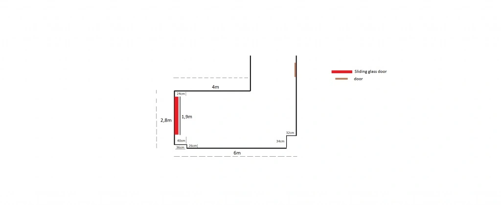

Provide a drawing (floor plan) of your recording room. What kind of music/vocals are you recording? What microphone(s) do you have?
this is my room floor plan.We re recording rap,blues and other kinds.Does it matter?

Try recording without any acoustic treatment first. I'd set up the mic so you are facing at a slgiht angle towards whatever that opening is to the top right of your drawing - this lessens the amount of direct reflections coming back towards you.
Next, try some absorption material directly behind you with the mic in the same place - you can hang a big old comforter or duvet on the wall and over the sliding glass door.
