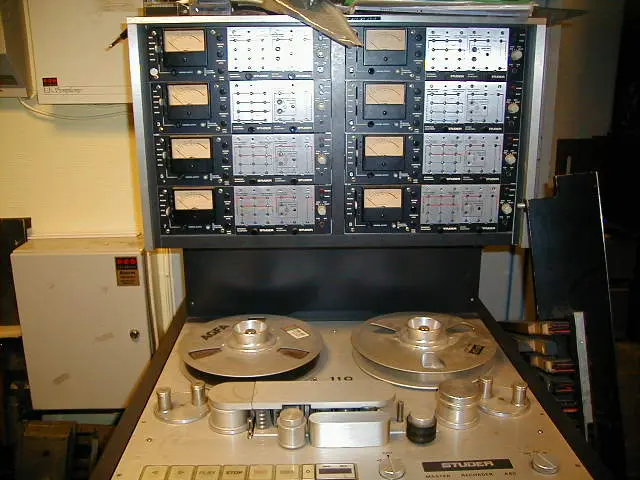

Studer A80!
Here`s one for sale($3000)
It`s in Norway.........
Amund

Hi Neve!
Cool looking machine - but I'm unfortunately a creation of the digital era (error?) and have no knowledge of working with such a beast. Can you tell me what all those cool looking silvery plates are to the right of the VU meters?
Various testpoints and pots to calibrate the deck.
