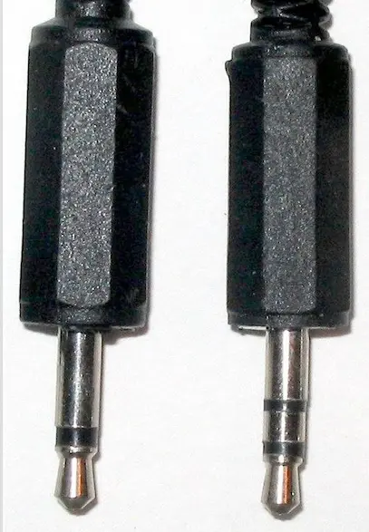

What kind of cable are you using? Is it like the left one or right one?
If left, that's the problem.

Steenamarro: Thanks for the great help. I am using the stereo jack the one on the right. I looked thru a bunch of my computer literature to see if the input jack on my computer is mono or stereo but couldn't find anything. I think I have the connection figured out: I plugged two 1/4" mono jacks into my tape deck (Left and Right Line Output) and on the end of this pigtail is a 1/4" female jack. I plugged a adapter into the the 1/4" female jack. On one end of this adapter is a 1/4 " male stereo jack and the other end is 3.5mm stereo female. To this I attached a cord with a 3.5mm stereo jacks on each end, one end into the adapter and the other end into my "Line-in connector" on my computer. The description for the "Line-in connector" is: "Connects to recording or playback devices such as a microphone, cassette player, CD player, or VCR". I used the "sound recorder" that comes with Windows 7 and made a recording of a tape and when I played it back it only played back in one of my computer speakers. I don't know if my "Line-in connector" is Mono or Stereo. I put a set of headphones on the 3.5mm output of the adapter I just described and sound came out of both ear pieces which means I am getting sound out of both channels. I checked the voltage on the stereo plug that goes into the computer and got voltage on both channels. I want the final product (a CD) to have both channels operating so sound comes out both speakers when I play the CD in a DVD player. What do you think of me just using the "sound recorder" that is included with Windows 7. The only editing that I want to do is divide segments up on the CD so that I can select specific tracks to play back like in a music CD where you can choose the song you want to listen to. Thanks again, John R
Have you any way to prove that this is a stereo adapter/converter? If it's mono, the damage is done at that point in the chain. Right channel gets grounded there and then.
You could prove by starting a recording with the setup as above.
Whilst recording, unplug the r2r left output and put it back in again.
Now unplug right and put it back in again.
If your recording has no interruptions then the pigtail you describe is just summing both outputs together. L+R into L.
