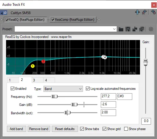

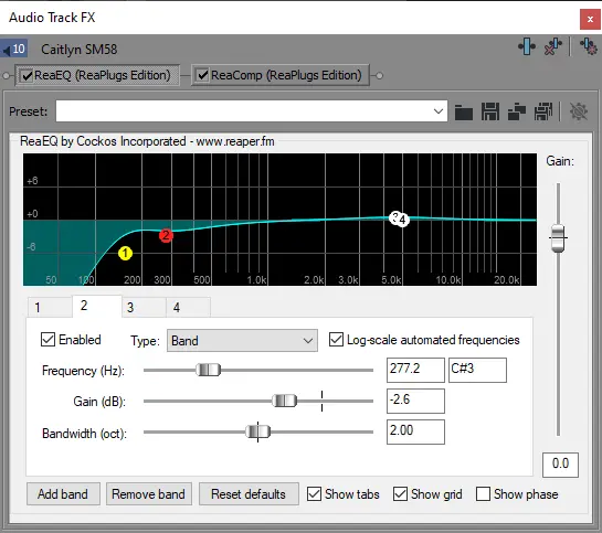

Here's an actual eq curve I used on a recent live recording. This is on a female lead vocal with a live band behind her. She's singing essentially right on the grille with no additional pop screen. On a male vocal I might have rolled the HPF down a little. I'm using a band cut rather than a low shelf cut because a lot of the lower part is covered by the HPF. The cut at 277.2 is wide enough that it's having some effect well above 500Hz, which is consistent with how high the proximity effect boost goes. There's a subtle clarity boost filter at about 5.5k.
If you sing at a greater distance then you might not need as much of a cut, but I wouldn't be afraid to do whatever is necessary to make it sound right. You're not making a scientific measurement, you're creating art.

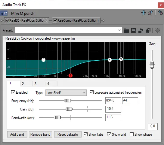

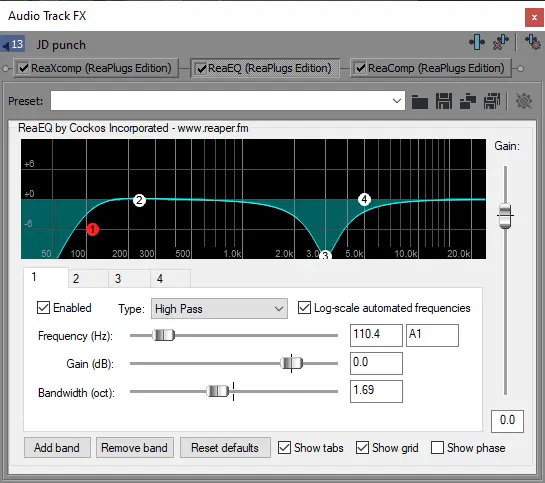

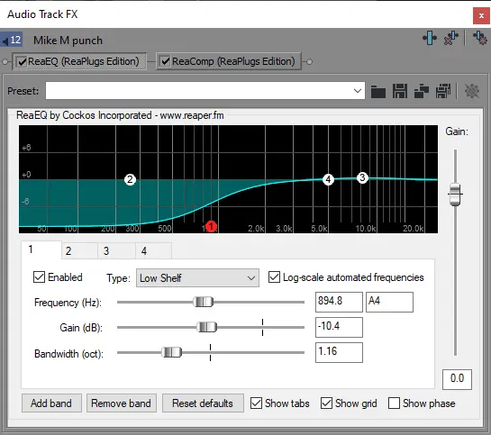

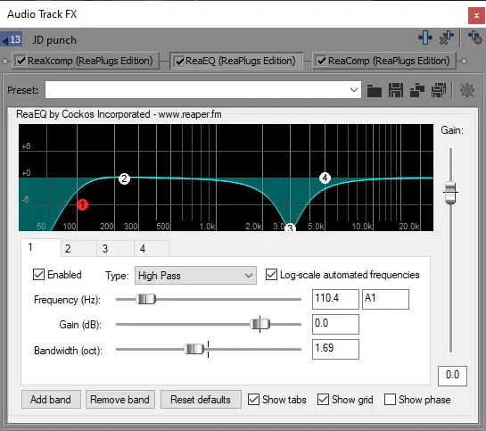

And here's what I did on the backing vocals. We re-tracked them one at a time using the same studio mic and more or less the same placement. The mic captured a full representation of each vocal and I carved away what didn't fit.
