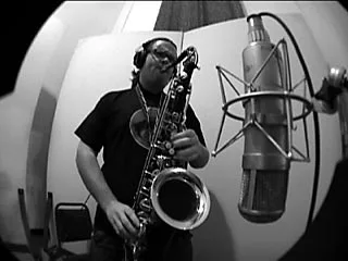

Check this out.
I've got a bunch of other similar pics, but don't have the time to upload them at the moment.
I prefer to use a sennheaiser e604 close to the bell, then a LD condensor, like a SP B1 a little further away.

Yo Neil:
Pretty cool photo. Kind of looks like you're doing a gig on the "Enterprise" as it soars through space.

I didn't mean to mislead you - thats not my pic. I got it off of a band called Less Than Jakes website. They've got a section on the recording of their new record and that was one of the pics.
Bit of an eye opener some of those pics, to see how the pro's record.

yes... apparently pro's record through a fish-eye lens!
"apparently pro's record through a fish-eye lens!"
YeGawds, I always wondered how they got that WIIIIDE Stereo "image"... Steve
