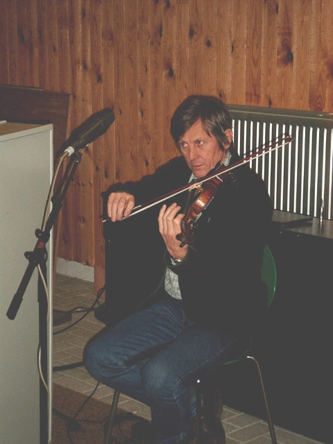

I don't know any of your mics personally, but these are the things people learned me (& which I've seen used with success)
Listen to the instrument and put the mic where it sounds best :)
In general they put a LD over the instrument, a few feet away over the player. I attached a picture of an example.
To his right there's a gobo and next to that there was a cello player. She had a C414 in front of her, 1-2 feet away, also pointing at the spot between f-hole and the point where the bow makes contact with the strings.
Pointing more at the strings gives a little harsher sound, more to the F-hole is rounder.
Acoustic instruments don't like to be processed. If the player is ok and the mic's placed right you won't need any processing other than ambience. Get the best room you can, meaning let them play and have it sound 'right' in the first place.
...maybe it also depends on what sound you want. This example is the most used method, but if you're after a Beatles kind of string sound... I wouldn't know how they did that (sounds like there's a mic inside the instrument, guess that's real close miking)
hope this helps,
Herwig
