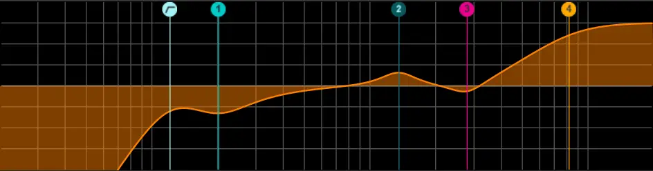

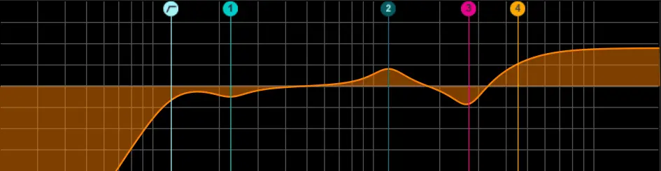

Here's the EQ for the SM7B without CL-2
Here's the EQ for the SM7B with the CL-2
That's how I got first image to sound as close to my original EQ in second image.
In the end like I said, I prefer the sound which comes with all advantages with the CL-2.
You’ve got lots of HF boost here so I can see how the residual noise of the mixer would become difficult. It strikes me you might maybe consider backing off the mic a little, and using your new found gain, and maybe then to get the sound you want you’d not need so much eq. I don’t think I’ve ever used such radical EQ, the need for that suggests to me it’s the wrong mic, being forced into submission. As i mentioned I don’t like that mic and a friend had had it on long term loan for over a year now and I don’t miss it at all. I know many love it, but the need you have for such radical cut and boost worries me. If you get the right mic in the right place, then EQ for me, is gentle and specific. gentle small hills not mountains.

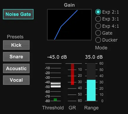

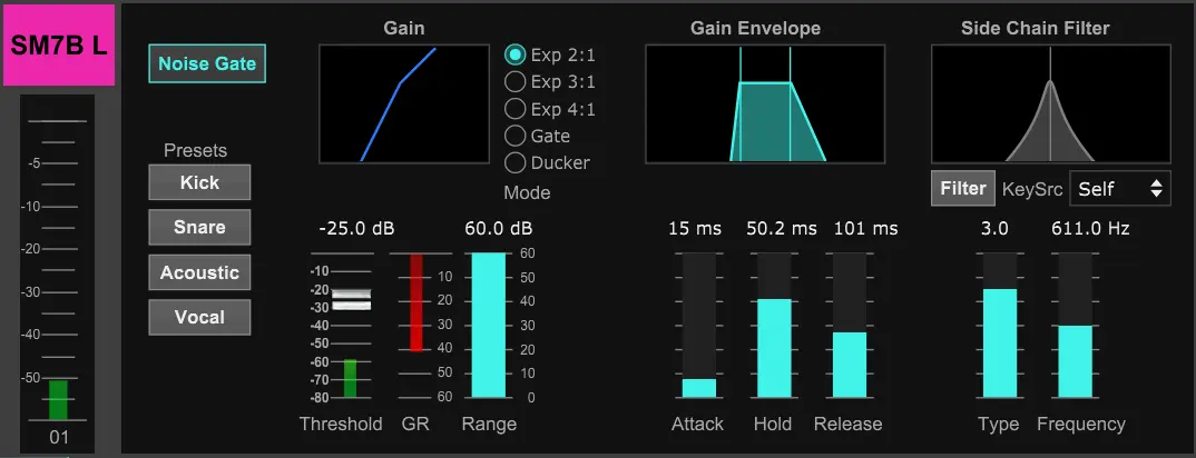

I'm already using an expander which removes everything when I'm not talking. It's really tight and working almost instantly. I have a dual computer streaming setup near my microphones and they're coming in. Also sometimes the AC in the background.

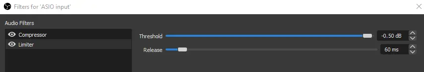

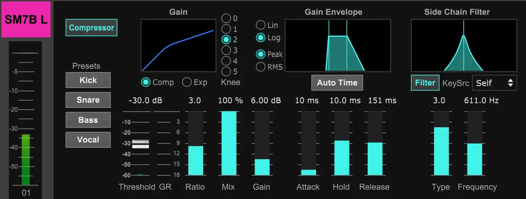

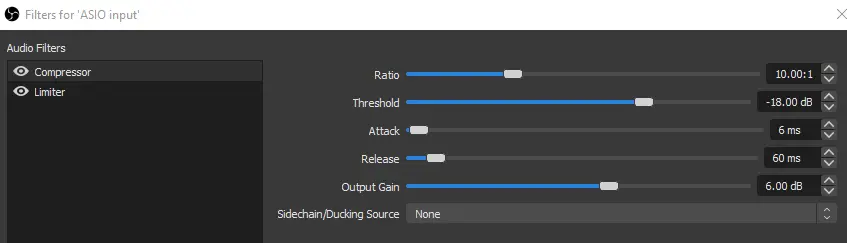

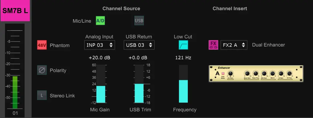

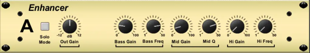

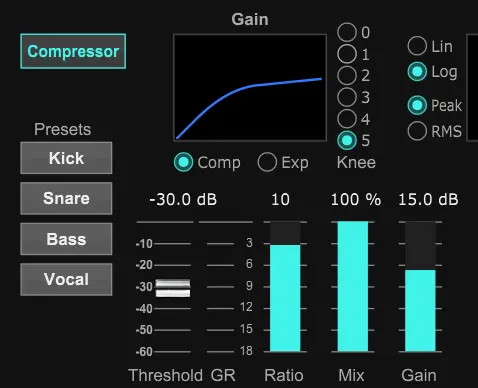

Here's my signal processing path
