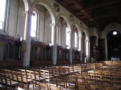

this is where i will be recording. im going there on monday to get some measurements and get a proper idea of the space in which i will be working

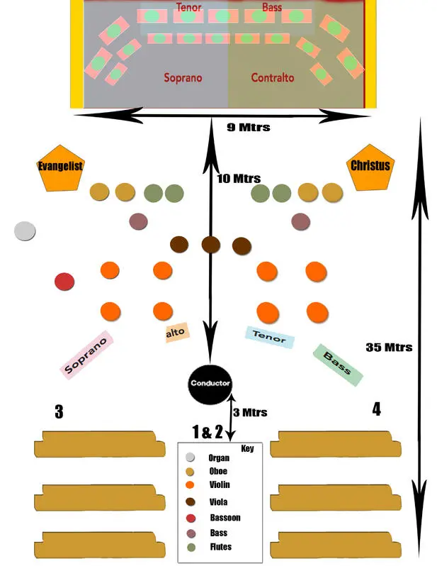

If you decide to go w/ the additional omni outriggers their distance behind the main stereo array should be inversely proportional to their spacing; i.e., if they're 3' apart you could put them 6' behind the X/Y pair; if they're 20' apart I'd put them on the same plane as the main pair. But again, in this configuration I'm suggesting, those omnis are just there to provide additional ambience cues, so whatever arrangement compliments the main pair without interfering with its imaging is fine.
How about mixing a spaced pair with the ORTF
please see the diagram i have provided
1&2 = AKG 414 ORTF
3&4 = Earthworks QTC 1's
is this ok?
how am i going to account for the 321 rule when the distance from the source is about 13 metres?
The reason I suggested X/Y rather than ORTF for the main pair is because your spaced omnis are going to provide more than enough interaural time difference, so you want a very stable center image from the main pair. The true coincident nature of X/Y achieves this more reliably than any near-coincident array ime.
By using your ears. And the faders on your mixer.
