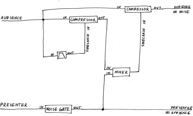

I've come up with an idea to gate the HVAC noise out of my audience mics. The gist of it is: Only let the audience audio through when the presenter isn't talking and the audience is.
To determine when the audience is talking, I'll use a narrow bandpass filter. This should mostly eliminate HVAC noise and let through a very low-fi signal of just the audience and presenter speaking. This signal will drive the sidechain input of a compressor on the audience mics. The output of the compressor is the audience audio (with HVAC noise) except that the audio is muted when the audience (or the presenter) is talking. A mixer combines this signal and the presenter audio. The output of the mixer is only silent when the audience alone is talking. This signal goes to the sidechain input on a second compressor (which has the original audience mics as its input). The output of the second compressor is the audience mics muted at all times except when the audience is talking.
I've sketched up a diagram below:
The next step is to run some tests in MatLab with some audio clips I've already recorded. Let me know if you think it won't work (and why). :-)
