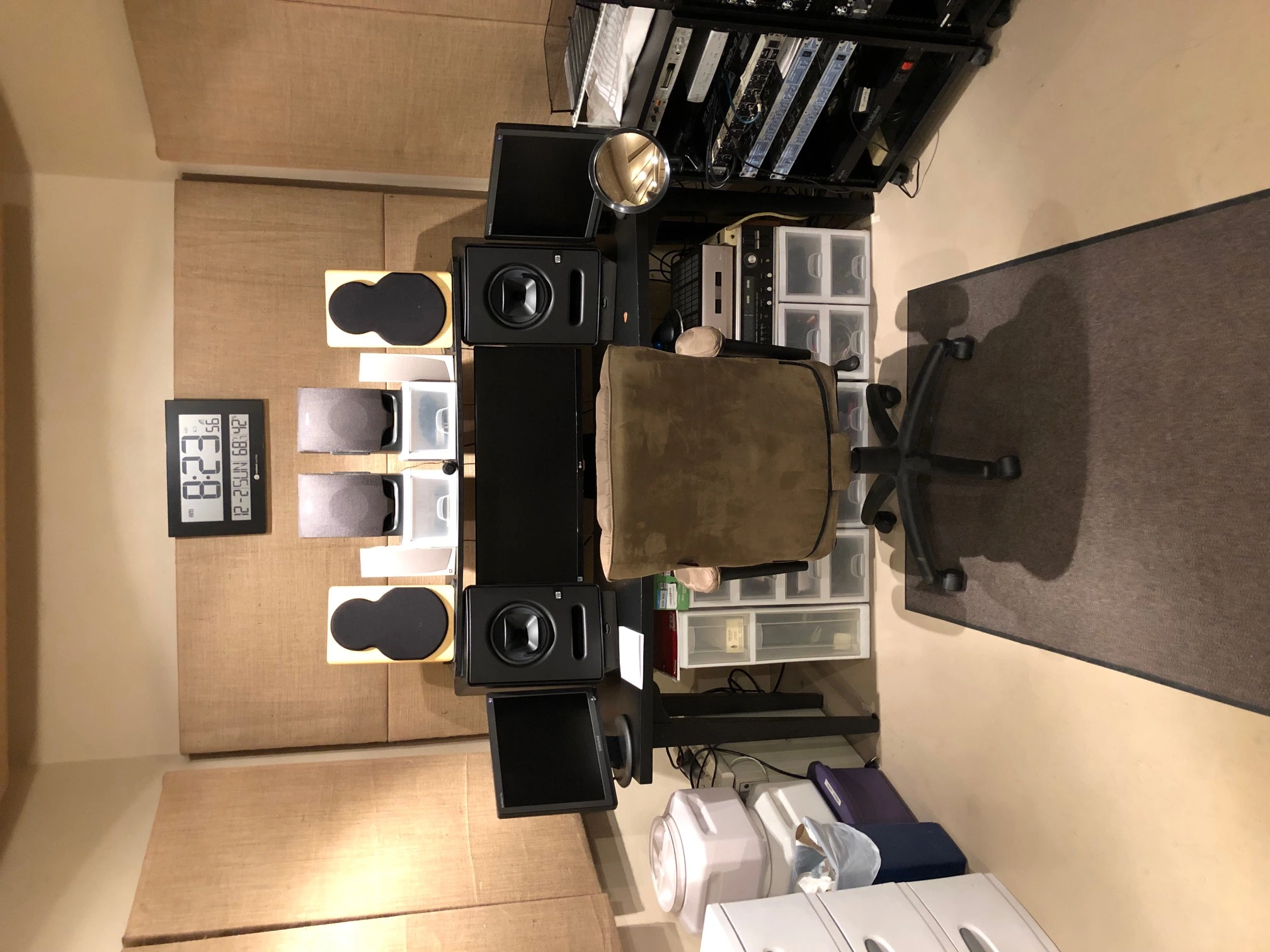

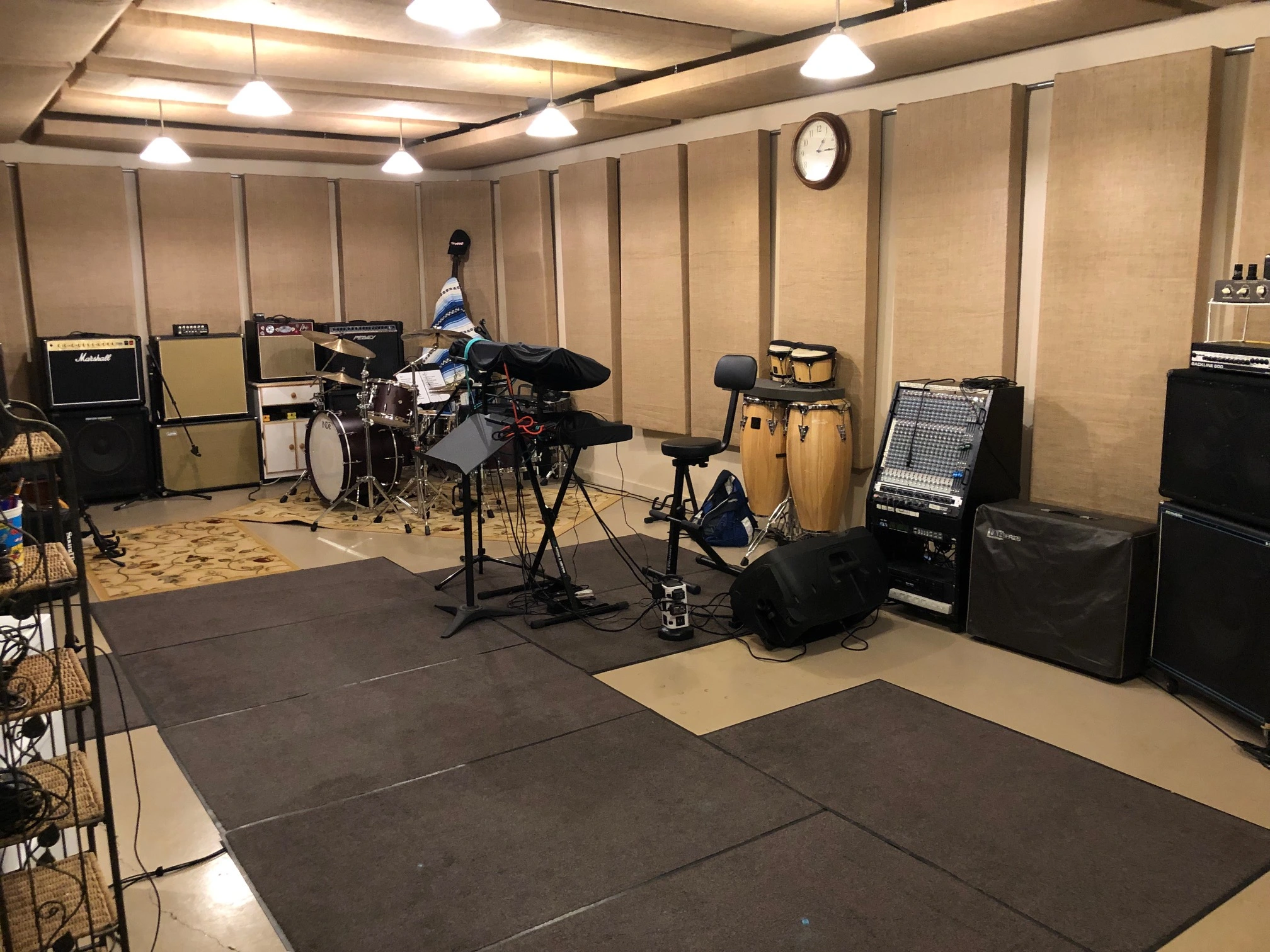

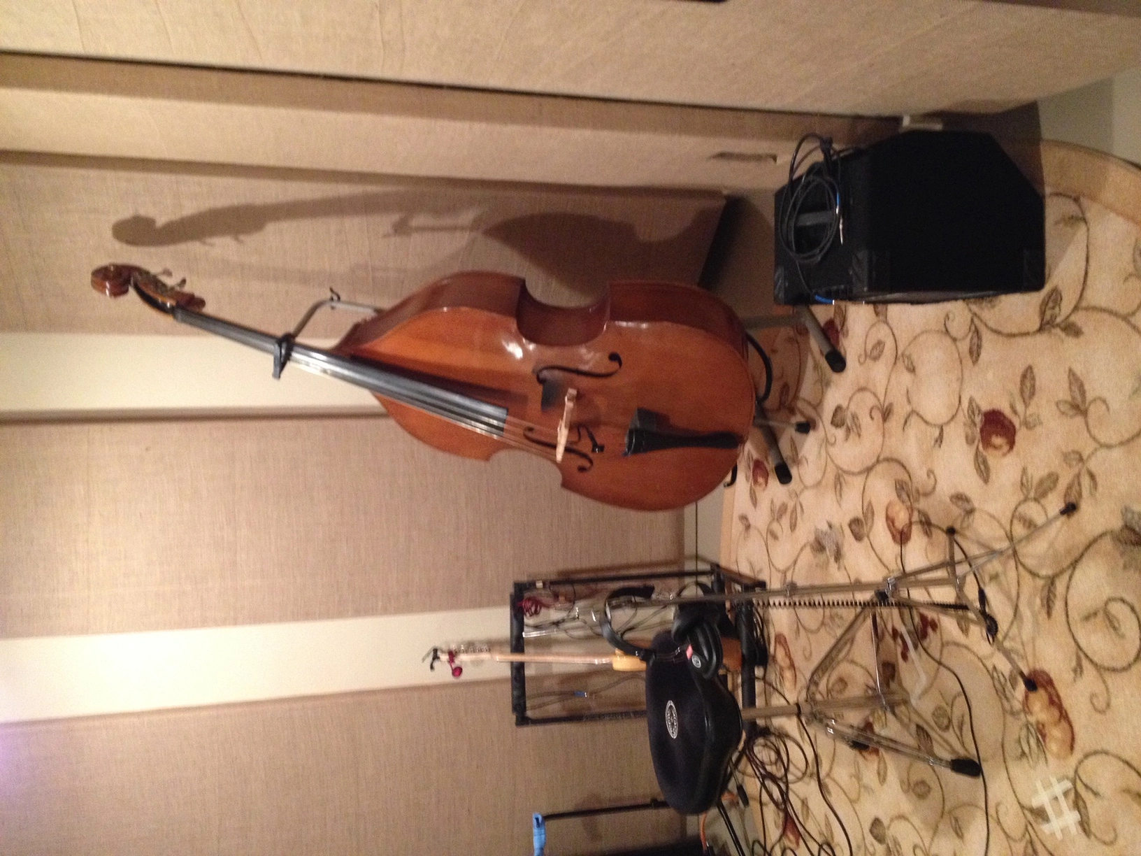

I had well over 80 panels I made for my place.
Most were 2 ft by 7 foot with 2 inch thick to 4 inch thick compressed rockwool.
Hung a boatload from the ceiling, and made numerous corner bass traps from floor to ceiling that were about 14 inches deep at the greatest depth.
I hung the wall panels on 3/4 electrical conduit I ran the length of each wall and put hooks at the top of each panel where it held the top about 4 inches away from the wall and the bottoms touched the wall creating a varied air gap.
I can simply lift them off the conduit or squeeze them close.
I was initially going to make about 6 of them with paneled backs so I could build some light floor frames I could hang them on to use them as gobo's.
I never quite made the time for that...LOL that was over 15 years ago...LOL
I think your ideas are close to what I also had in mind.

Damn, that's a lot of panels! :D
Hey, what's the clock on your wall at your mix station?
I have one with a similar type od readout, but it's smaller, and from a distance not as easy to read.
I would love to get one like you have. Where did you buy it?
