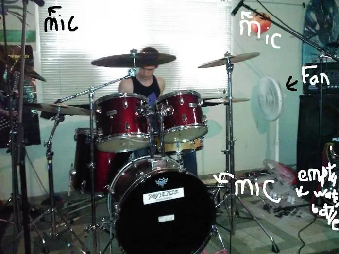

Well here is the drum recording. Time stopped us from doing much else but next Saturday we planned things out and have 7 hours so we should at least have two songs recorded. I didn't do much to the recording other than EQ and haven't even edited it. Pretty much a raw recording. Here is a pic of how i mic'd it.
It was a hot California day in a stuffy garage with kilawatts of equipment running and a full sweaty band that just got finished practicing and the neccasary 5 random people who showed up that we have no clue what they are there for. The fan and water bottles were necessary.
Either lose the fan or put a mic on it!
It was off while recording but im pretty sure that that was a joke i missed. How does the recording sound?
Also how would i get more out of the cymbals? EQ only works to a point.
Have the drummer play, then listen through headphones as you move the mics around. Slight changes in mic position can make a huge difference in the sound.
