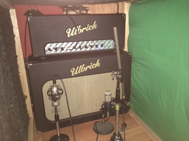

I can so relate to the original poster. I, too, have tried everything under the sun. After more than 4 years of endless research and experimentation, my tones are just as bad as they were 4 years ago. I have tried every knob combination and every mic placement known to man, and nothing seems to sound like a real guitar recording. Put the SM57 near the cap edge, too fizzy. Put the SM57 away from the cap edge, more midrange but dull. Put the mic on the grille, full but ridiculously bassy. Pull the mic away from the grille, better but thinner and fizzier again. My amp sounds great in the room with all knobs around noon. Great midrange, with just a bit of honk, and a nice high-end sparkle on top. Just like Maiden on Piece of Mind. On my recording, it sounds extremely scooped, nothing but fizz and boom, no midrange or body.

I stand by what I said back in Dec 2018. Also use Multiple mics and record to separate tracks then mix them together to build the sound you want. I have attached a photo from a session I recently did, the guitar sound with virtually no EQ is fantastic. There is a SM57, A ribbon mic, and a LDC. The placement on the speaker cone is important. The reason for the close mics only and the baffles is that this album was tracked live, drums, bass and guitar together so I had to minimize spill.
