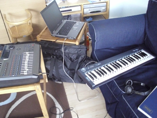

When I use VSTis, I have all the various instruments housed in Cubase 5 essentials in my Toshiba tecra laptop. The soundcard is a one in, one out Echo layla. I rigged up a lead with a ground loop isolator which kills any hum or buzz [when the computer is plugged in, I used to get this awful buzzy humming or hummy buzzing and my mate said it would go only if I used it on batteries. The annoyance of that, and a guy in a shop saying there was no solution led me to the ground loop isolator]. That then goes straight into the DAW. The various sounds are triggered by my CME MKey 'dummy' keyboard. rig-001.webp
