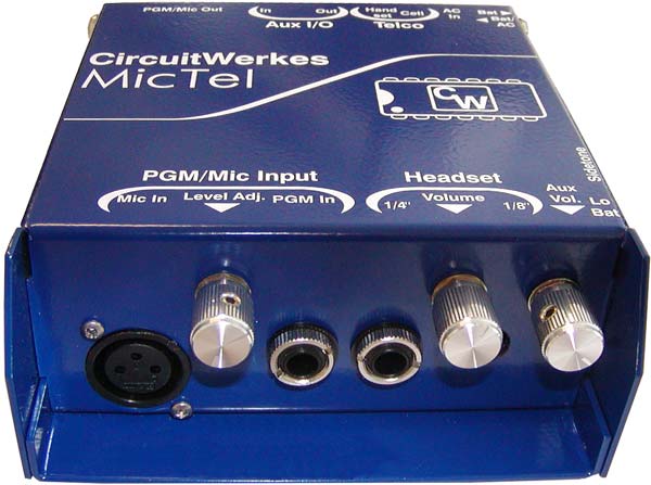

Dan,
You may need to get a little bit more sophisticated. This device is specifically used for capturing cell phone... and land line... calls.
Trouble is it's not quite as cheap as a patch cord. Click on the image (just showing off).
