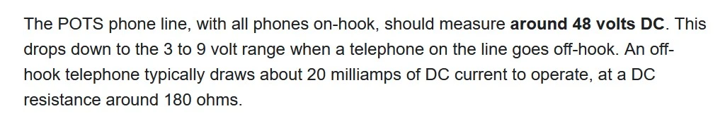

Wouldn't you want the Off hook voltage? Cause you pick it up it drops to 4-6 volts. That would be operating current..the off hook range.
Conveniently, phantom power is 48V
Conveniently, USB is 5V
Something should be workable in that problem set.
