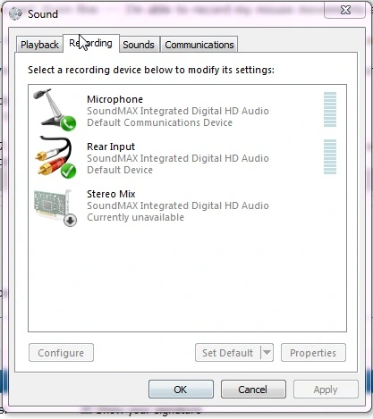

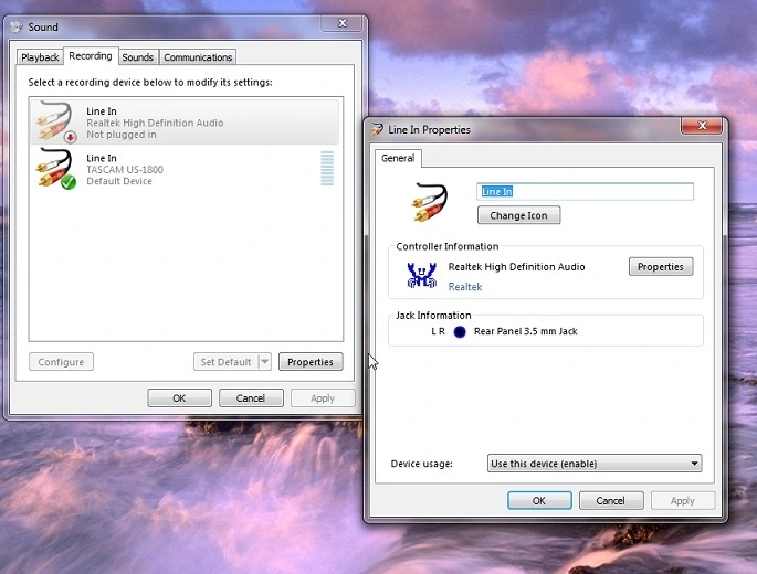

I'm on Windows 7, and when I open up my "Recording Devices," this is what I see (attached photo). As you can see, there is no "Microphone" option, as there is on my office computer (see other photo).
I have a Rode VideoMic that's battery powered with an 1/8" input, and I was actually kind of just hoping I could plug that right into the mic input of the computer's soundcard to get something quick and serviceable, but when I tried that, the volume level was extremely low. However, I can't find a way to adjust an input level for the mic jack, because it doesn't show up in Recording Devices.
I can't get anything else other than "Line In" to show up on my Tascam US-1800, and I don't know what that refers to. It has 8 channels of XLR inputs, six 1/4" inputs, and one stereo digital input ... so what would "Line In" mean? I already tried plugging a dynamic mic into XLR channel 1, and that didn't record anything.

Hi Nola, thanks for the reply. The problem is that I can't find a level adjustment for the mic input on my computer's soundcard for my music computer. See the screenshots I attached. On my music computer, no microphone input shows up --- just a "line in" for my soundcard and a "line in" for my Tascam interface.
On my office computer, which doesn't have a USB interface, there is a Mic input shown (see screenshot), but not on my music computer.
Right click in the blank area on the "recording" tab. Anywhere in the blank area should be fine. A menu should come up. Click "show disabled devices", then enable the onboard soundcard mic (or just enable all whichever the options are). I'd also turn off the Tascam interface or disable it to make sure the computer is using the right input.
Thanks for the tip. I turned off the Tascam (and it disappeared from the list). When I right click and select "Show disabled devices," the only other option that shows up is "Stereo Mix (Realtek)." I looked around in its properties, but there was no microphone option anywhere.

I also notice under your recording tab you have 2 default devices. That seems strange. When looking closer, it's the Tascam and the onboard mic. So when you unplug the Tascam, it's now using the onboard mic since it's set as a default. That's why it's recording your mp3 through the room. So what I'd try is removing that onboard mic as a default. I forget how to do that, but you can probably just right click and disable it. Then plug in the 1/8 and see if it works.

I'm confused by the two default devices comment. I think you may be mixing up the screen shots from my two different computers (music and office). In the first screenshot (music computer), there aren't two different default devices; the Tascam is the only one showing Default.
In the second screenshot (office computer), there's a Default Communications device (microphone) and a Default device (rear input).
