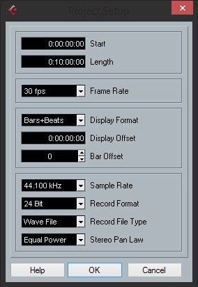

Are the projects at same bit and sample rate?

Here's cubase
Not sure how I check this in reason. There's no plugins that are causing the problem. The bars in Reason start just a little too early. For example, say a drum track starts on bar 2 in reason, then I have a guitar track that starts at bar 2 in cubase. The drum track in Reason starts RIGHT before the bar 2 in Cubase starts. It's too early in cubase, but is on time in reason. I don't get it. It's like the tempo in reason is a hair faster than cubase.
