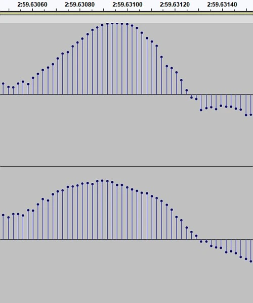

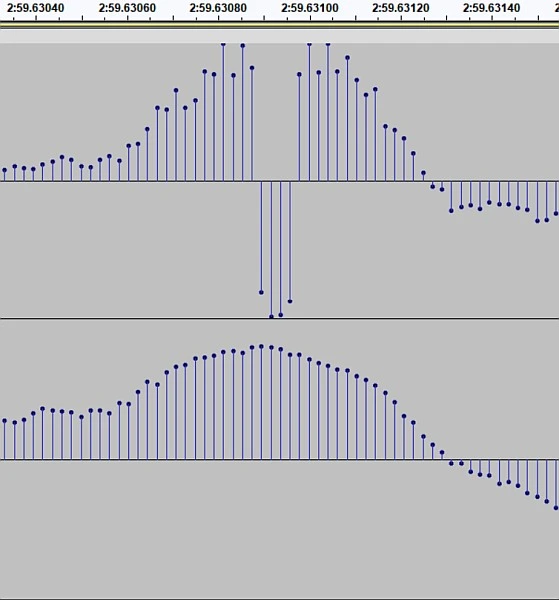

You can bring a copy of the offending wav file into Audacity, zoom in to the point that you see "lollipops", click on the little pencil icon to go into edit mode and actually edit out the spikes. You'll never hear such an edit. Then export the file at the same name, rate and depth as the original and you can replace the file in the project. I've done such edits dozens of times. Here's a before and after shot. Instant fix.
I've just checked and Audacity does have an interpolate function - although it calls it Repair.
This is probably the cheapest way of fixing things provided the click is less than 128 samples long. Other software can fix longer clicks.
