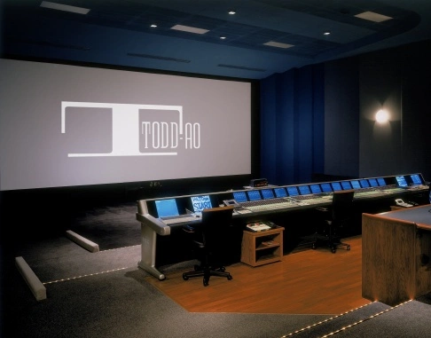

Because I bought the mixer you see in the picture, and I want to use it.
Hey, I've got one of those. Picked it up cheap on Craigslist. PM me and I'll tell you what you need to do to get it all going.
Your problem isn't the interface between the Avid Euphonics 5/Eucon hybrid desk and Pro Tools. Avid can help with that.
Much more difficult is fitting a 768 piece orchestra into a typical 12x12 home bedroom along with that mixer.
So you have a space that big in your studio...?
WOW!
It must be a REALLY big bedroom. :p
That looks like a video/film post-production studio...they always tend to have the mixers with massive channel-counts because they'll put every little sound on it's own channel. I also doubt they use 768 channels simultaneously. Odds are they are there for alternate mixes and other duties.
