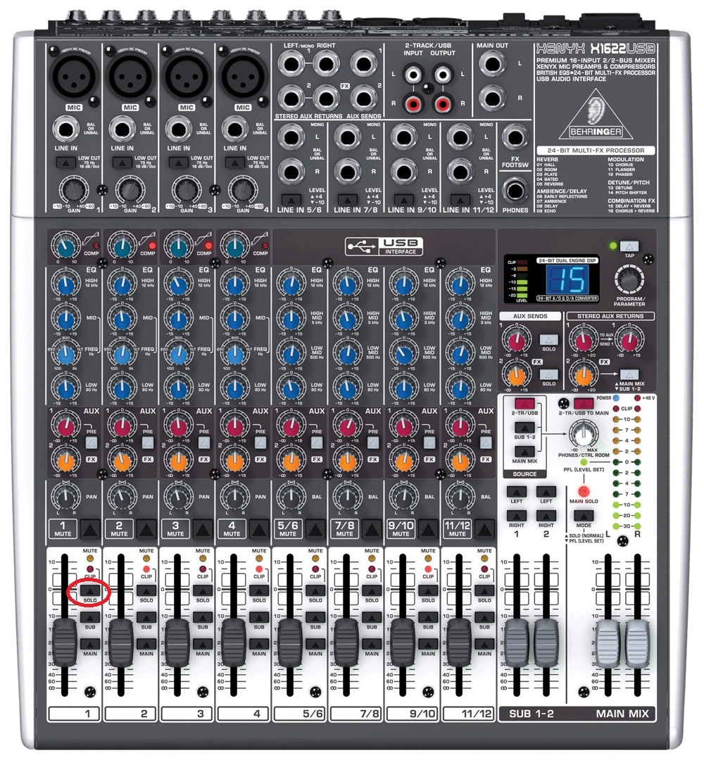

Okay so I bought a MXL V69i Tube and I am running it with the Behringer XENYX 1622USB ..... Which is the problem.....
I am running straight USB to my computer from the XENYX. I am not running anything else other than the microphone to the mixer.
I plug my headphones into the mixer and set everything to how it needs to be to record into Adobe Audition......
When I have my "SOLO" button unclicked I can hear the music from the computer just fine BUT I am getting a tenth of a second delay when speaking into the microphone. BUT when I click "SOLO" and the red light comes on, I hear myself in real-time but no audio comes from the computer.
I am confused and don't know what to do.
Any suggestions?
Yes, the only time I hear the music from the computer is when "SOLO" is off..... Just to show the button here:
The button circled in RED when pushed down the red light above it comes on "CLIP" and I can hear the mic in real-time perfect but no sound from the computer. It's like I stop hearing all sound from the computer period. But when it's off and the RED "clip" button is off, I hear everythign but there is a delay in the mic.

Hmm. Are you using ASIO or MME as your device class? Maybe lowering the buffer can help it sync better.

Well poop on me, I got it working! ...... Thanks man. I forgot to, ignorantly, uncheck "listen to this device" on my computer...... LMAO
