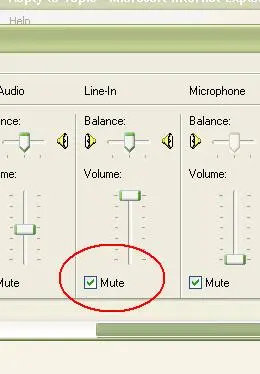

Open Windows Mixer (double click small speaker icon beside clock on taskbar)...
Mute the Line In...

Ah yes, I thought of that before, but I figured that it would mute the signal going into the recording program too, but actually it makes sense to me now.
Thanks a lot
