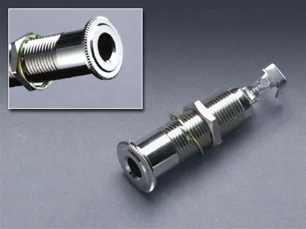

I have an Ibanez rg7621 7 string guitar that has recently started shorting out. I opened up the guitar assuming that that the jack itself just needed to be bent to make a tighter connection (cable feels a little loose when inserted ). I have done this numerous times on my Gibson guitars. At any rate, this is the only Ibanez I have ever owned and I was surprised to find a barrel type connector that is much longer than your typical 1/4" guitar jack. So this brings me to my question. The contact points inside the "barrel" have obviously become more spread out than they should and it isn't holding the cables connector as snugly as it should. Is there anyway to get in this thing and bend the contacts back or is it toast? If I need to replace, does Guitar Satan carry these things? Is it an Ibanez specific jack? I have owned a lot of guitars and never come across one quite like this. Anyone have any idea what I am talking about?
thanks in advance!

the output jack will have to be replaced.
it is a really simple fix if you have any experience soldering wires.
j
Sloan that is the jack style. I suspected that it would have to be replaced but since I had never encountered one of these I thought it was at least worth asking. Soldering is not a problem. I just need to find out if they carry these locally at Guitar Center. Thanks again for the info guys!
I have an old Ibanez bass that did the same thing, and had the barrel type connector, I just put in a new typical guitar jack worked fine.

Those Ibanez jacks are notoriously crappy. I've even replaced some on brand new units. Buy a nice Switchcraft barrel jack replacement and you should be set for a long while.
