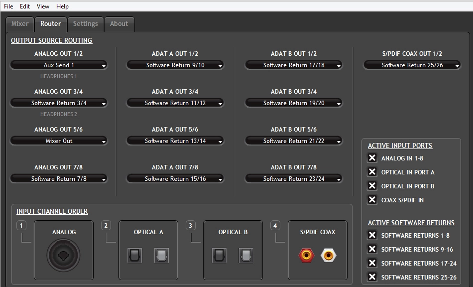

I just bought a headphones (Shure SRH440) for my profire 2626. I was having problem routing them but i finally got them to work. but now that its working, I can only hear a sound from one side of the headphones.
Please give the routing setup for both headphones and monitor without affecting each other.I'm not sure If I did it right.

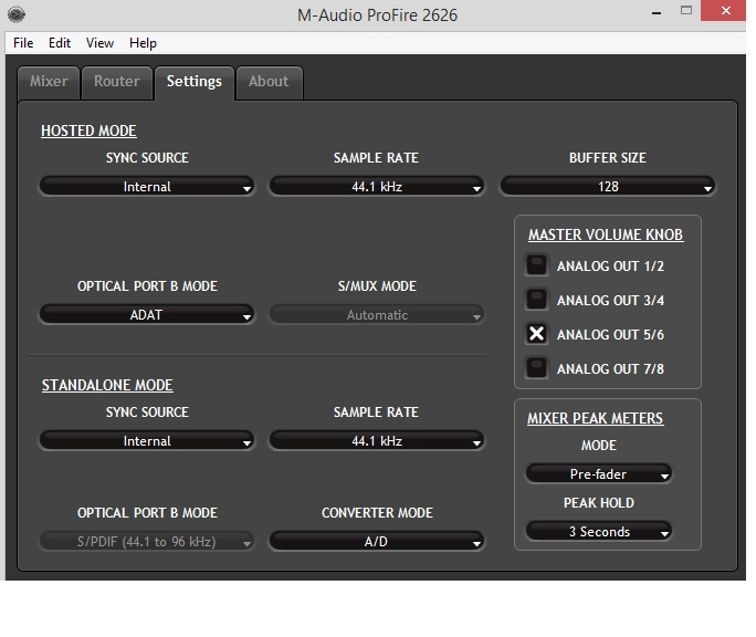

I have my monitor out on Analog 5/6
Heres what I got

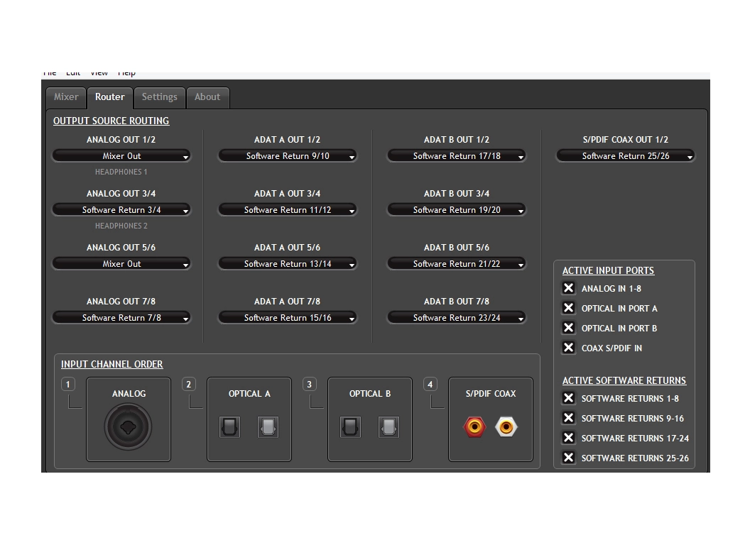

under analog out 1/2---->>> Mixer OUT and under the Master Volume Knob check Analog Out 1/2
THis thing is complicated for me too.

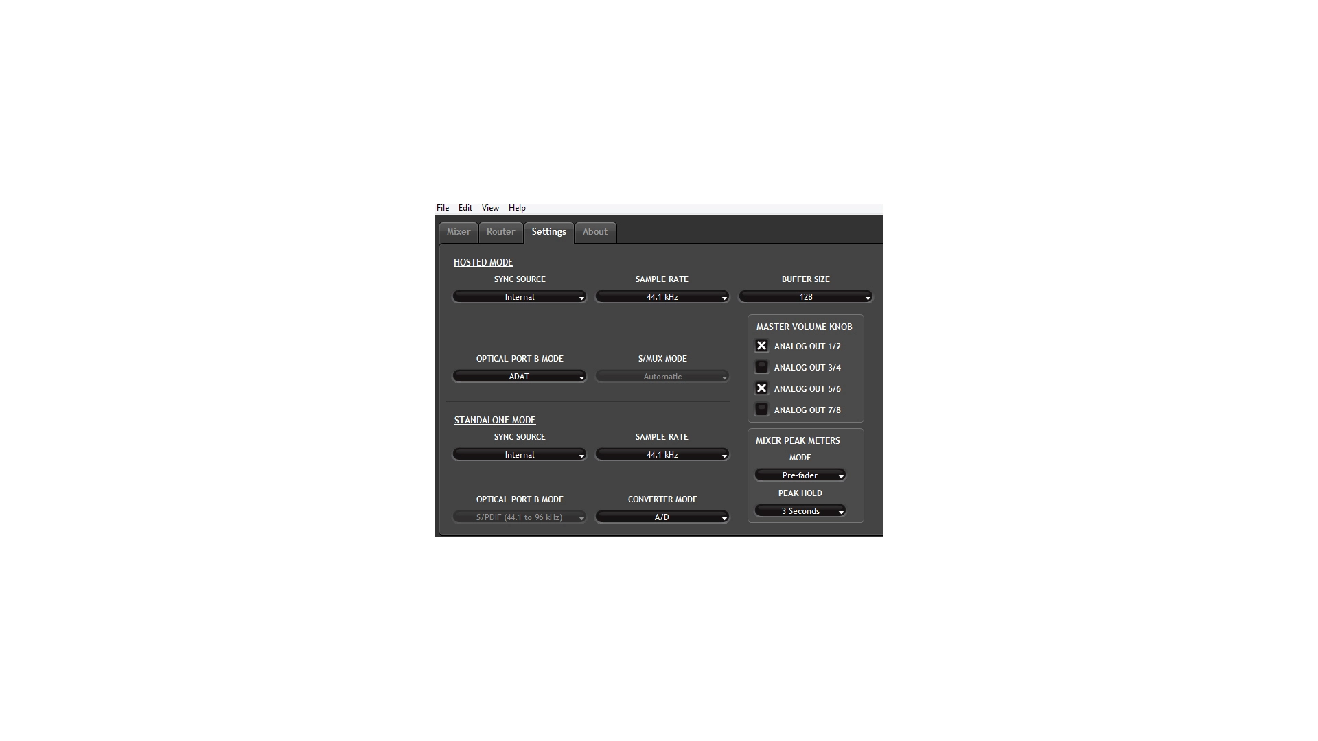

because analog 5/6 and analog 1/2 have the same routing, the sound coming out of the headphone is now controlled by the master know. so, it still doesn't solve the problem but thanks tho

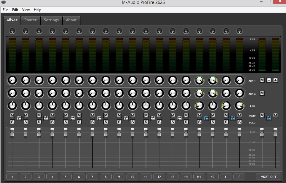

nothings changed. The sound coming out of my heaphones is still only from the left. My headphones are working both sides. I tried it.
there IS a sound coming out of the second headphone output if I make the Analog 3/4 Aux 2

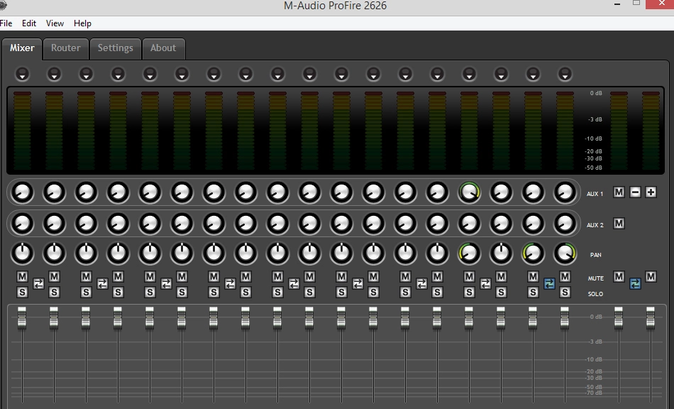

Its weird because when I try this and use the headphone 2 on my profire, i get full wide stereo even though the knobs in the picture arent even asfaf.webp
but when I do this on the Headphone 1 I only hear sound on the left
