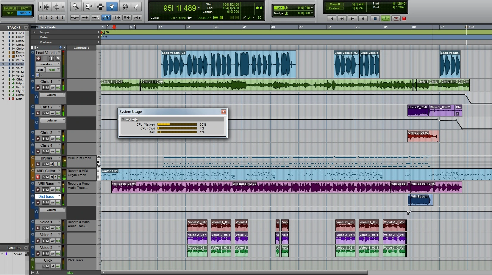

Mostly it runs beautifully and the CPU monitor has never registered more than 30% CPU Usage. I have layered up many Audio Tracks and some Midi and Instrument Tracks with good results.

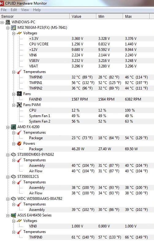

I have run Pro Tools with a reasonably heavily loaded song with lots of Plugins in use and the USB Keyboard powered up. I haven't had a crash yet. I ran the Cupid Program as Recomended, I don't really know what the values should be but the screen shot is below along with the Pro Tools usage Monitor.
I guess the 2 worrying things are the 12V voltage being down at 9.5V and the CPU fan having hit 100% a few times.
Any advise based on the below info.

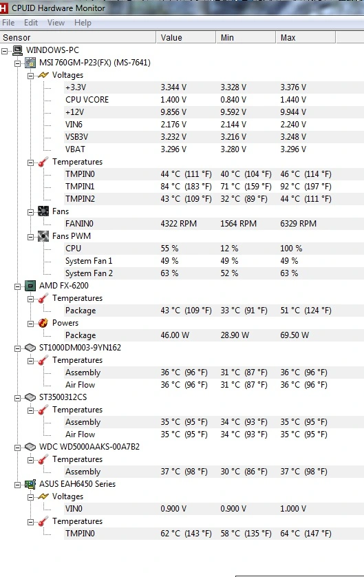

And here are the temps a few minutes after shuttng down PRO TOOLS and just browsing the web.
The only fan hitting 100% is the cpu fan, and TPMIN is hitting 92 degrees, so it's reasonable to assume TPMIN1 is cpu.
I'd be very concerned about it peaking at 92 regardless of what it is.
If you're anyway handy, remove the cpu heatsink/fan and make sure it was fitted properly.
I don't get the feeling that workload is especially important here.
A cpu with no heatsink will burn out before it even posts so I guess moderate use is just pushing your system over the edge, heatwise.
I'm guessing there's no thermal paste on the cpu/heatsink, or it's not clamped down properly.

The CPU Temp on the screenshot is listed further down under AMD-FX-6200 and peaked at 51'C. I do not know what TPMIN1 is, I was hoping somebody may have known. I am prety certain the CPU has not got up to 91'C.
Despite that screen shot showing info for 3 fans, I actually only have the 1 CPU Fan which is fitted to a large Copper Core Heatsink which was an upgrade I opted for as it was supposed to keep things cool and quiet! The only other fan is the PSU fan. I don't know why it shows system fan 1 and 2? I am thinking of fitting some cooling fans to the case now though as there does seem to be warm air circulating inside.
Hmm, yeah. I see what you mean.
I guess it's probably north or south bridge then. Both of those would have heatsinks.
The safe advice is DON'T let it get that hot again.
It's a bit annoying because if you did it'd be very easy to find out what part is getting hot and what fan is going overkill.
Case fans are definitely a good idea, but I doubt lack of them is directly responsible for the problem.
I guess I'd just remove and check all other heatsinks on the board. Something's not fitted properly.
