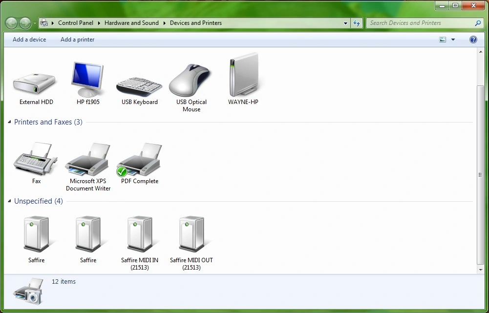

I installed a SIIG firewire PCIe card with TI chipset. Today I hooked everything up and immediately came upon a problem: Windows said it couldn't find a driver. I went to the focusrite website and downloaded the only thing they had available (Mix Control 3.1). Both Mix Control and Saffire Control are not detecting my Saffire device even though all 3 green lights on front of the box(power, FW and LKD) are lit up. I'm looking at my device manager and I'm a bit confused by what I see. There appear to be 2 separate Saffire devices
The Saffire device on the bottom, far left seems to be the one that the controller is trying to connect with but the one to the right of it is the only one that gives me sound configuration options. I'm assuming that the saffire device on the right is the one I want the software to detect. Does anyone know what is going on here?

I found a 2-year-old post on a different forum which gave me my answer. I knew that there was obviously a conflict in my system but I didn't know where. I just needed to disable the Realtek sound card driver and that fixed it. I can't believe I didn't think of that.
