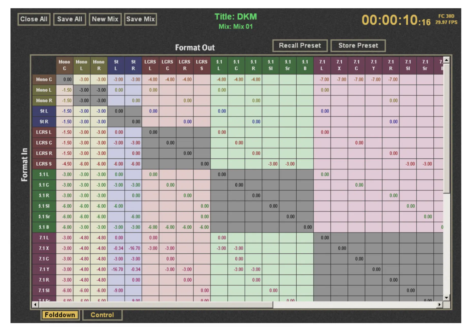

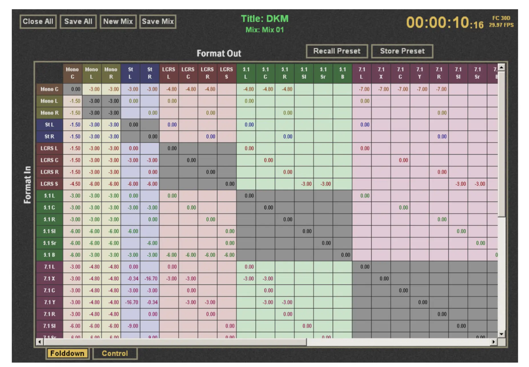

There's a picture of the default fold matrix I usually use for non-atmos projects. Thats a screenshot from the system computer that controls the i/o of the center section of the console. Some guys like FOX TV and some smaller regional networks have really different formatting specs than Netflix or BlueRay standard...when I export ADR or DX stems in a foreign language I need to have some extra tricks up the sleeve because some companies overseas want deliverables at radically different specs than the ones here.
With Nuendo I would just manually re-enter those blocks (in the picture above) into the user defined fold presets (if I needed them), but I'm pretty sure you can't do that in Pro Tools...hence the reason I'm using the Waves plugin.
